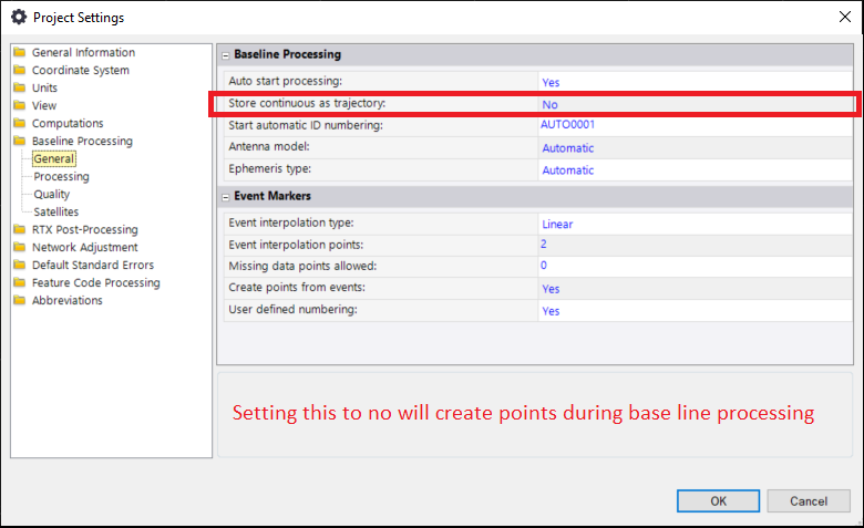

In the project settings you also have to set the following.
That way you should see a trajectory polyline and be able to determine when the shift happened. In the main baseline processing project you'll have to mask that time frame accordingly, as per the Webinar video.
