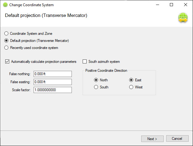

    While you can't change the current Grid template to Scale only, you still can change it to a scale factor or 1.
    If you change the coordinate settings to  Default Projection, check the box to automatically calculate projection parameters and set the SF to 1, it will recomputed to a SF 1 project.  The project won't display as a Scale Only, however if you inverse between points your Grid, ground and ellipsoid distances will be the same (if there is any difference it would be extremely small, e.g. 0.001')
    I know this isn't exactly what you were wanting to do as it doesn't display as a scale only project, however the end result would be a SF 1 project. I can put in an enhancement request to be able to actually display a scale only project when changed.
