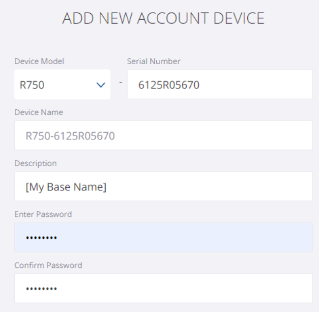

Device Model must be R750 [Other GNSS models are also supported]
Serial Number must match in R750 and WM
Device Name in WM must be the same as TCC Device ID in R750
Password must be the same in R750 IBSS Server and WM

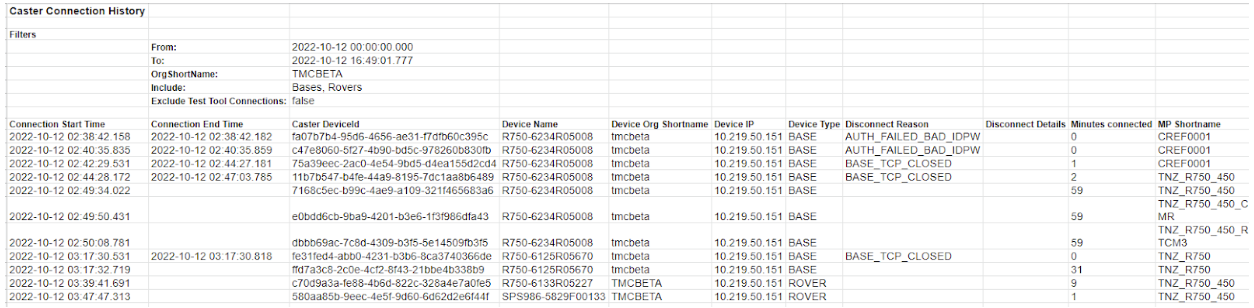

Status Information
The current status, connected devices and a connection report are available.

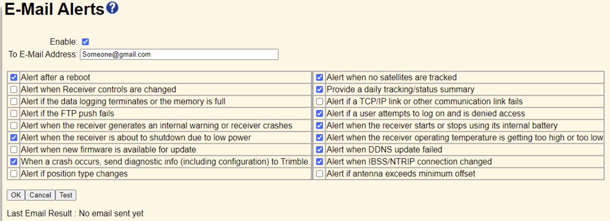

Notifications
Email notifications can be set up using the Network Configuration tab in the R750 web UI.
Using a Gmail E-Mail Client
Use the following settings for a Gmail account.
E-Mail Authorization Required – Select this check box
SMTP Server – Enter ‘smtp.gmail.com’
SMTP Port – Enter the SMTP port 465
Enable SSL/TLS - Select this checkbox to enable security
From E-Mail Address – Enter the Gmail address
E-Mail Login Name – Enter the Gmail address
E-Mail Login Password – Enter the App password (see below)
Verify Password – Enter the App password
