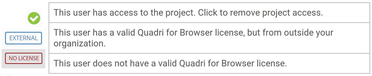

Searching for users to add
When you first start out with Quadri for Browser, you probably won’t have any users attached to your contract yet. However, it’s very easy to just add any users that registered with a Trimble ID. Just type the full email address of the existing user.
When you found the person you were looking for, you can push “Grant Access” to make this user part of your project. It’s also interesting to know that you can search for a part of an email address, often handy when adding multiple users of the same company:
If you don’t find the person you are looking for, please ask this person to establish a personal Trimble ID on this web page: https://np.trimble.com/
