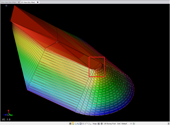

Hello TBC’ers! Have you tried out the “Adjust ‘flat’ triangles” property when building surfaces in TBC? This property helps to refine surface models by eliminating 'flat' triangles that can occur in areas with tight curvature. This adjustment ensures that triangles are connected to different lines rather than to themselves, resulting in a more accurate and visually appealing surface representation. Here is an example of flat triangles that we’d like to even out into a slope:

  1. The surface will now be adjusted to include triangles that connect two breaklines over a smooth slope.
