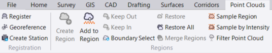

  2. Next, click on the “Point Clouds” tab on the top ribbon  and notice both the “Create Region”  and “Add to Region” tools.

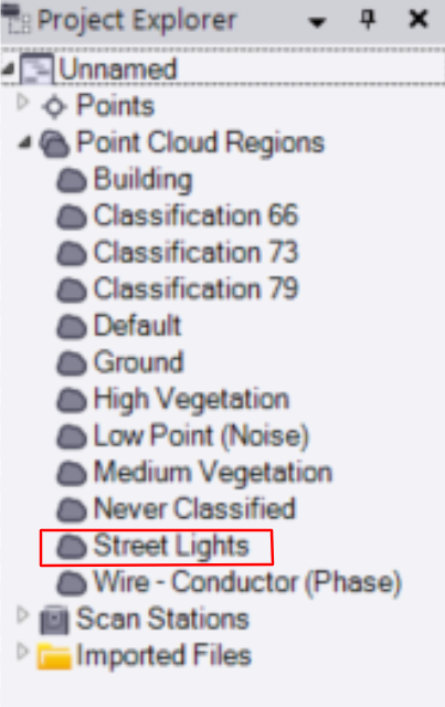

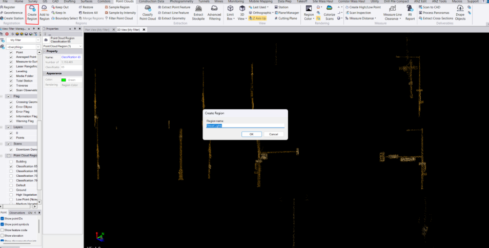

   3. With your dataset open, select an object of interest you want to classify (in this case, a street light) and click on the now enabled “Create Region” button from the previous step. This will open a new pane where you can label this new point cloud region. After clicking enter, your new point cloud class will appear in the “Project Explorer” pane under the “Point Cloud Regions” Section. Furthermore, the object you selected will now appear in a new color to indicate that it is part of that newly created region.
