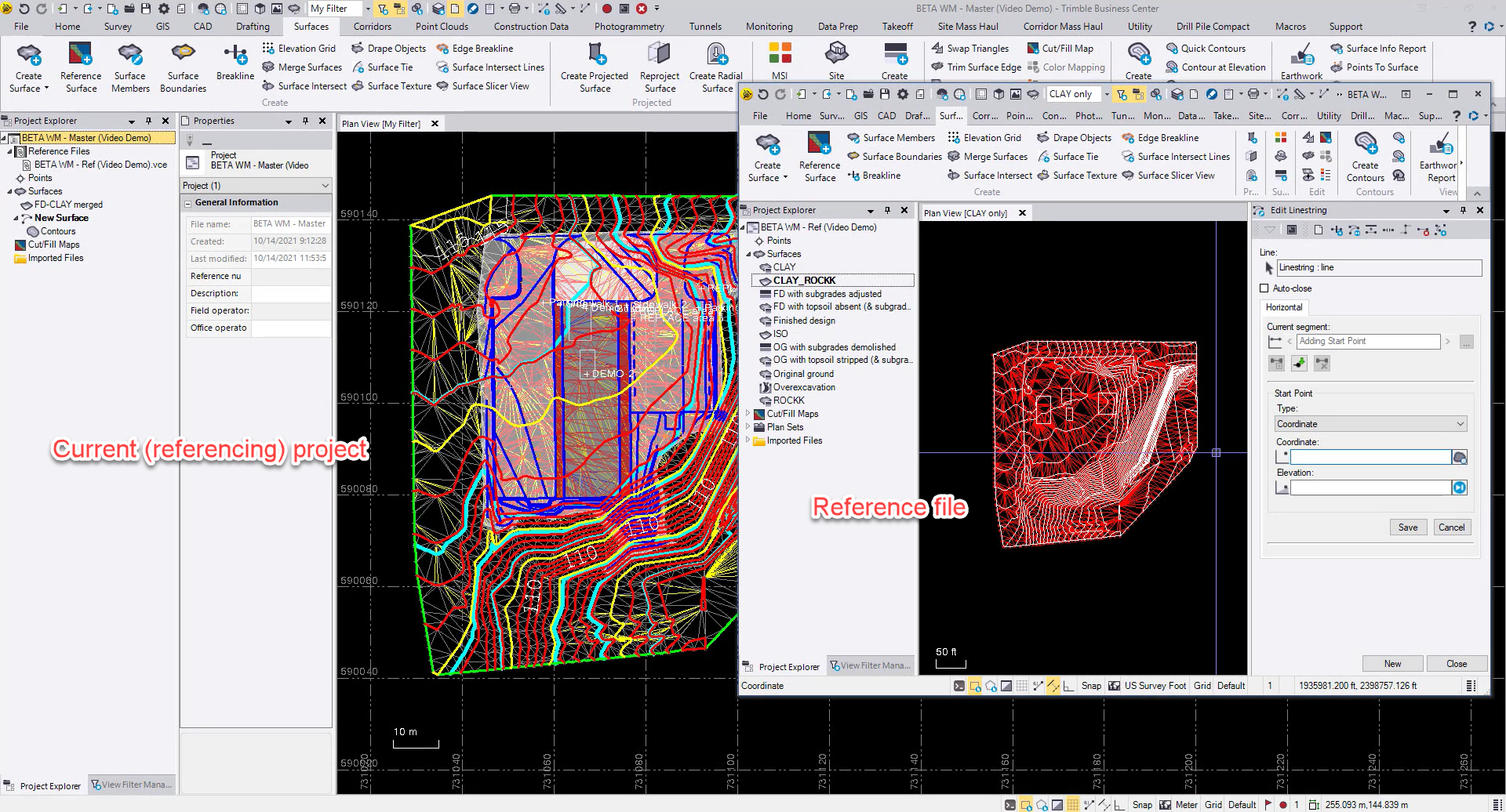

  • With your current project open, open your reference file in another TBC window and update your reference file as desired.
For example, here I went to CAD > Create Linestring > Edit Linestring to add a line segment to one of the layers.

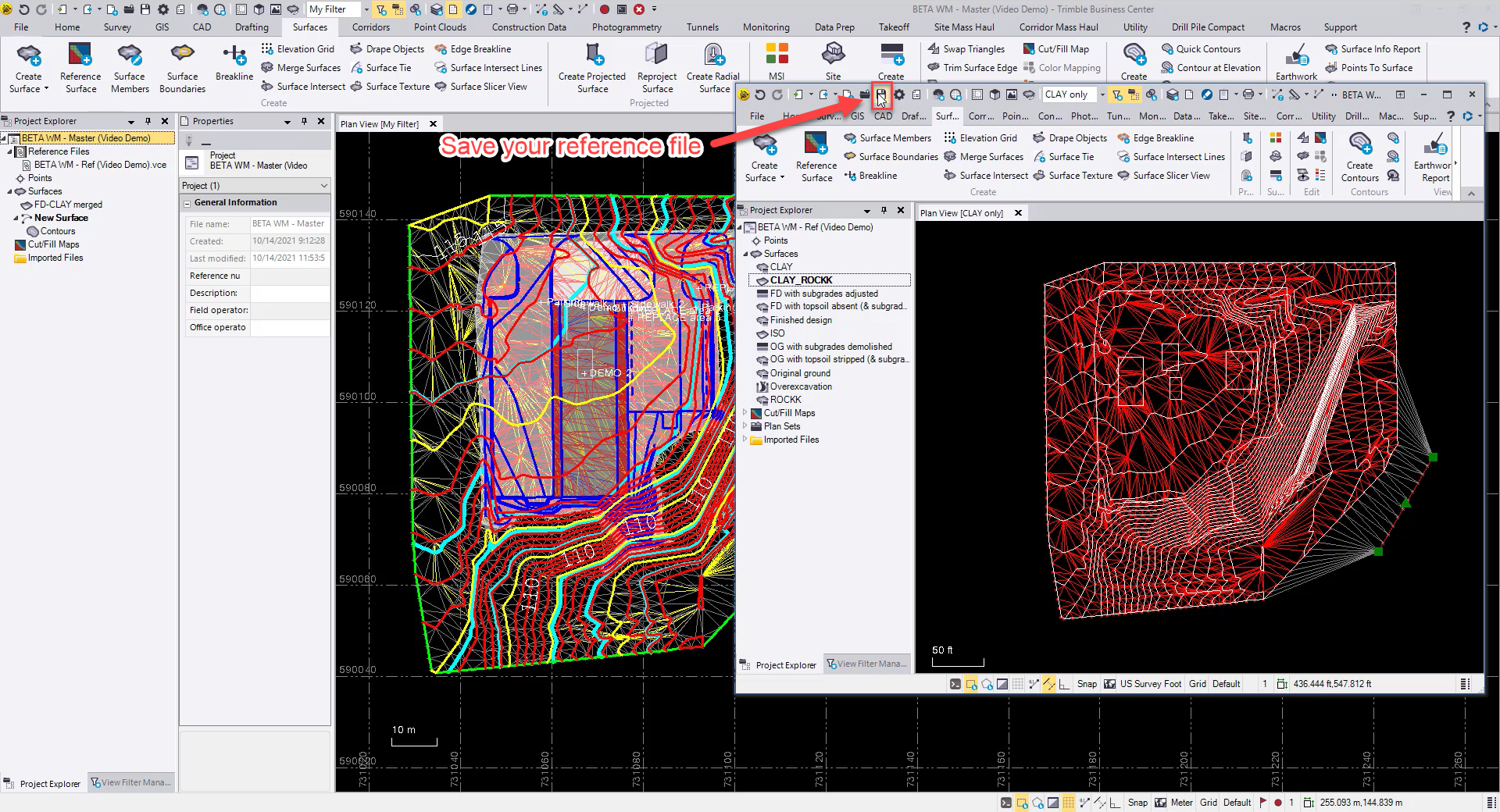

  • After your edits are complete, save your reference file to update it.

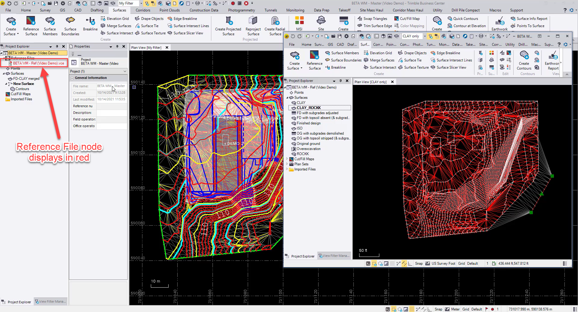

  • The Reference File node displays in red in the Project Explorer of your referencing project.

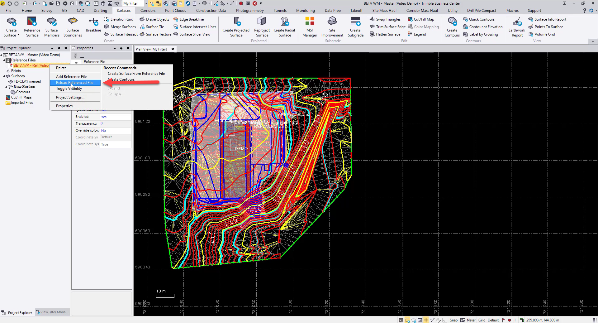

  • Right-click the node and select Reload Referenced File to update the reference data in your project.

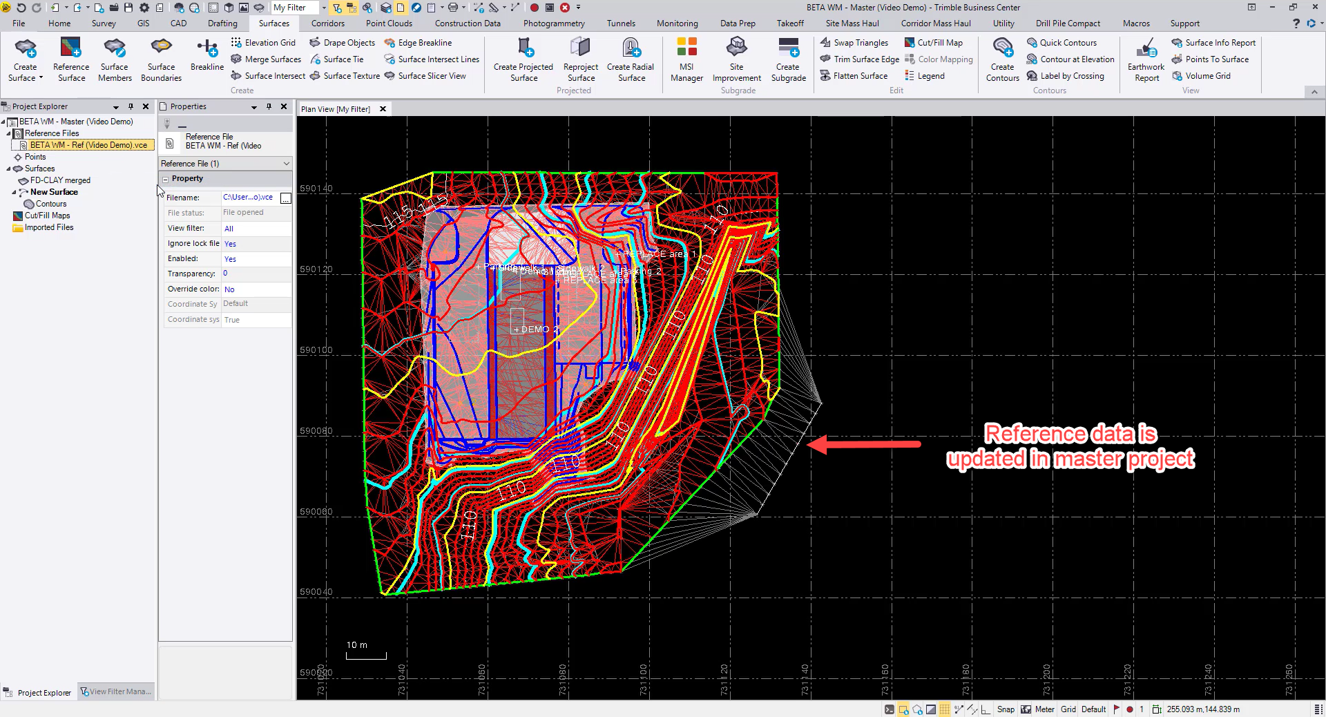

  • The reference data is then updated in your master project!
