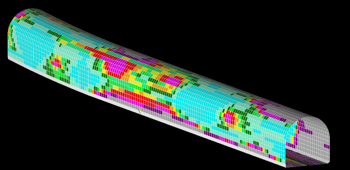

Hey TBC’ers! In underground mining and tunneling projects, visualizing the difference between the designed tunnel shape and the excavated reality is crucial. Today, we are exploring the Create Inspection Map command, a powerful tool within Trimble Business Center (TBC) for generating a map that visualizes the comparison between the designed tunnel mesh and the actual as-built mesh.

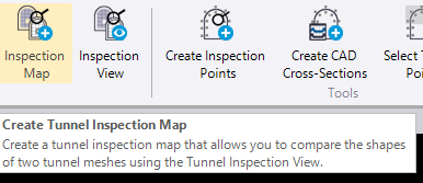

1. Open Inspection Map Command: Navigate to the Tunnels Tab and then select the View Menu. From there, choose Select Inspection Map.

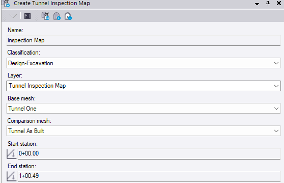

2. Create the Inspection Map:
  1. Name: Input the desired name for the map, such as Inspection Map
  2. Classification: Set as “Design-Excavation”
  3. Layer: Specify the layer where the results will reside
  4. Base mesh: Select the reference design mesh
  5. Comparison mesh: Select the actual scanned mesh data
  6. Stationing: Define the Start station and the End station
After entering the required parameters, click OK. The tool closes and the Inspection Map is Created.

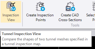

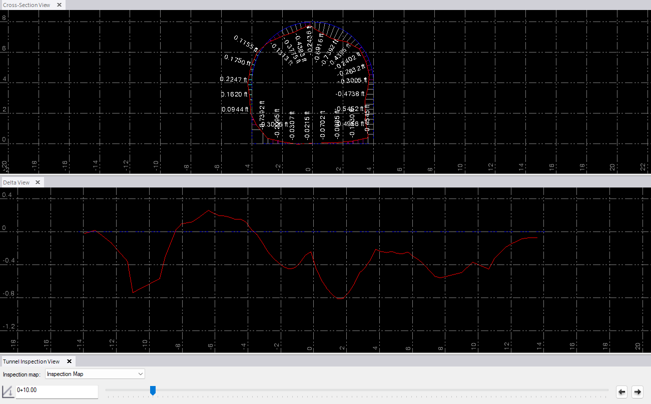

3. Review the Inspection Map: Once the Inspection Map is generated, you can dynamically view the results using the Inspection View tool.
  1. Navigate back to the Tunnels Tab and the View Menu.
  2. Select Inspection View.

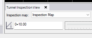

  1. You can change the tunnel inspection station, for instance, by setting the station change to 10 and pressing the Tab Key.
  1. Slide the station bar to change the view and inspect various points along the tunnel.
  1. Close the Inspection View when you have finished viewing the results.
