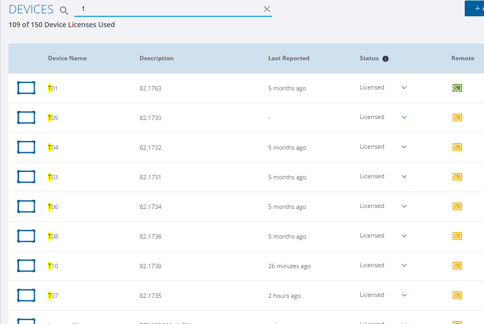

    We have a lot of tablets not reporting back correctly as to when they last reported.  They are actively syncing to established Works Manager sites.  The work orders are current via the "Field Data" link.  The "Status Message" data is old and not correct.  I also noticed that the ones with old last reported dates do not have an active project field populated, even though they are on active works manager projects.  You can even see in the graphic below that T01 last reported date was 5 months ago, even though the Active green icon indicator is on.   Is anyone else having similar issues?

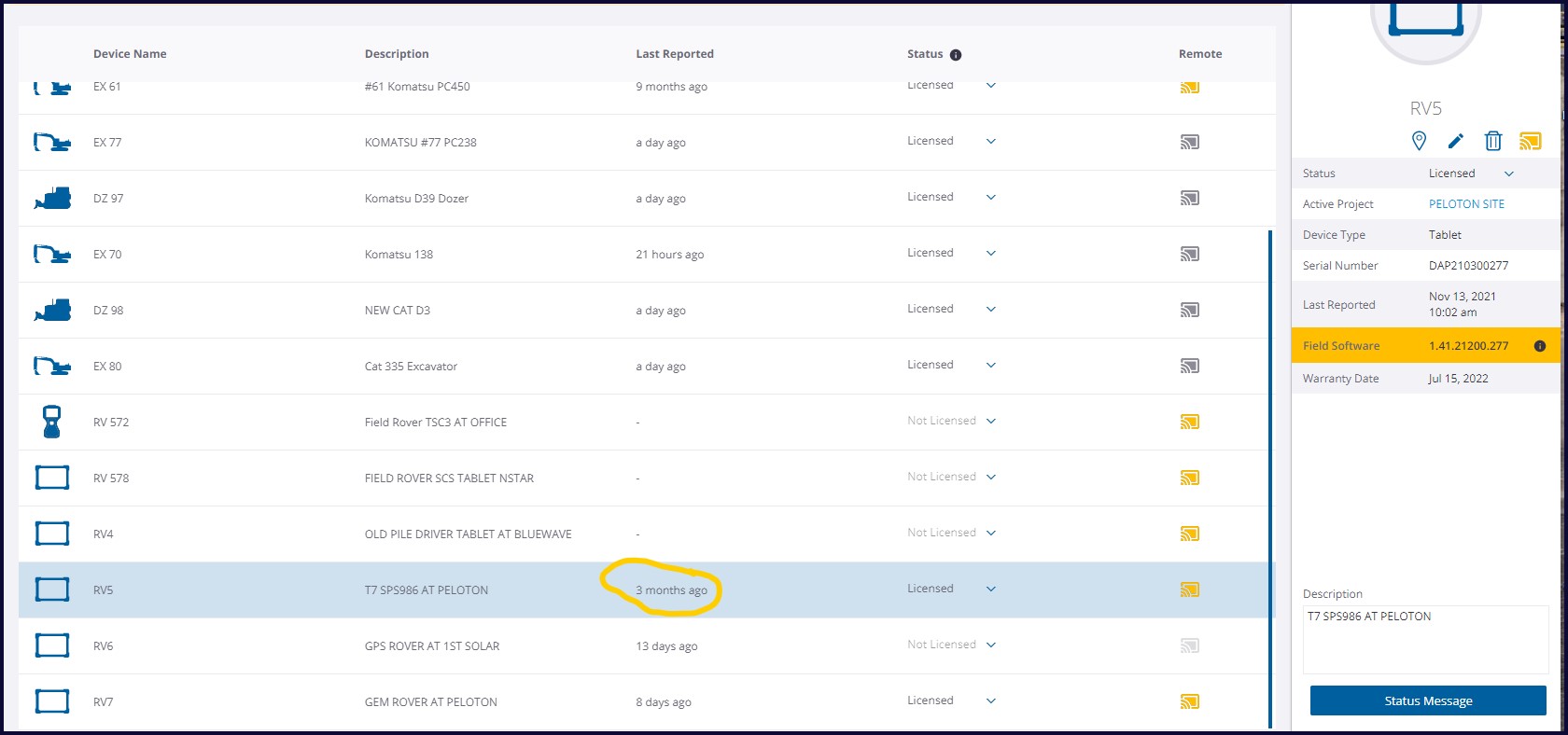

    Weird, works for us with that version.
    Our two latest additions 11 and 12 are still under software warranty but we haven't updated to 1.42 yet.
    All the other ones are out of warranty and run 1.40 or lower.
    They show last reported as Aug 31.
    Yours seem to have reported after that date, your screen shot shows Nov 13. Another Waitmanager mystery.

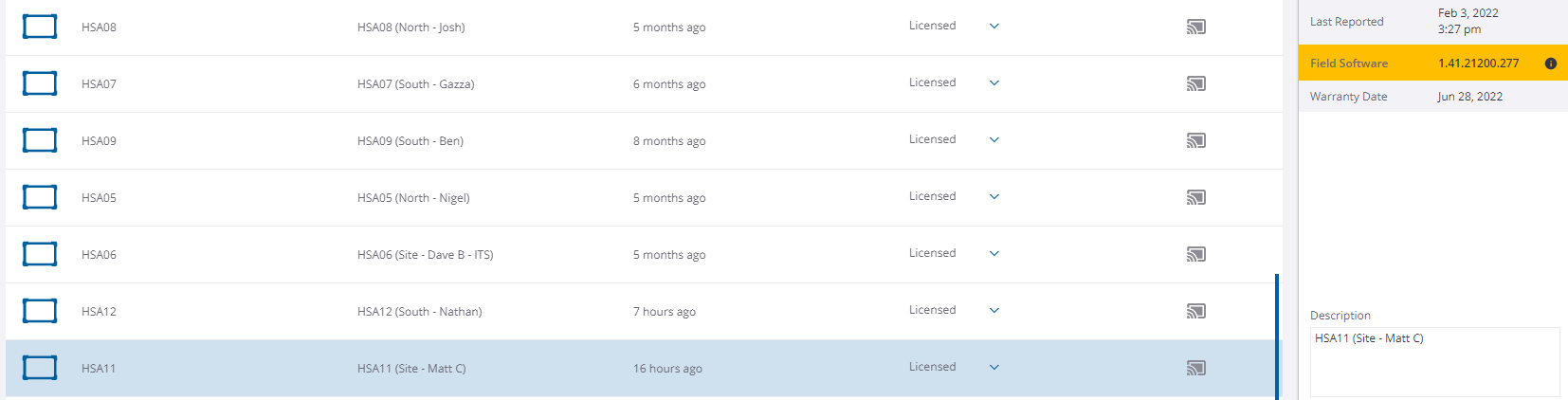

    Hello Matt, Siteworks moved to TID v4 for enhanced security measures in v1.41, however unfortunately could not support backward compatibility. You can look at the excel report (shared in a separate mail), and upgrade pending tablets to v1.41 or above. These devices should then start reporting and you will see the latest information (last reported, active project etc.) reflected in WorksManager.
    Regret inconvenience. Thanks for your patience, and support.
