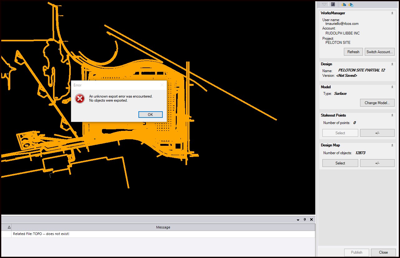

    Hello, after creating WM Design, I go to publish and receive the error in snap below. Never happened before on any project and this is one of a dozen or so successfully published.
    Any thoughts?
    Thanks, Tom

    I've had this happen when my connection has been bad to works manager.  I logged out and logged back in and it worked.  Might want to try refreshing your account as well.

    Anthony, it appears to be related to TBC generated contours in the selection. Sent files to support and am still waiting for a solution.
    The work around is using the export function and importing the svl/svd into Worksmanager manually.

    10 days and still no solution from Trimble Support.

    Update, I had a zoom call with Trimble Support. We were able to walk them through creating a design and they were able to see the same errors I was seeing.
    waiting to see what the engineers had to say.
