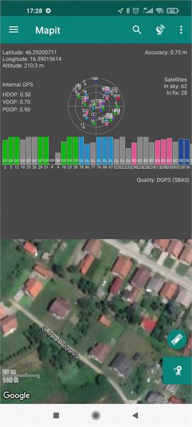

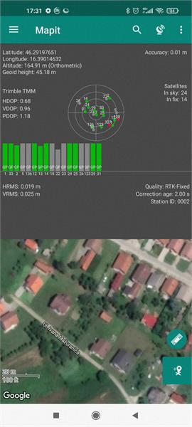

    Mi 10T support dual-band A-GPS, GLONASS, BDS, GALILEO, QZSS, but somehow I only see GPS satellites. When not connected to the TMM, all of them are visible. Please see screenshot attached.
    My NTRIP protocol supports GPS, GLONASS and GALILEO.
    Where is the problem? :(
    Thanks in advance.
