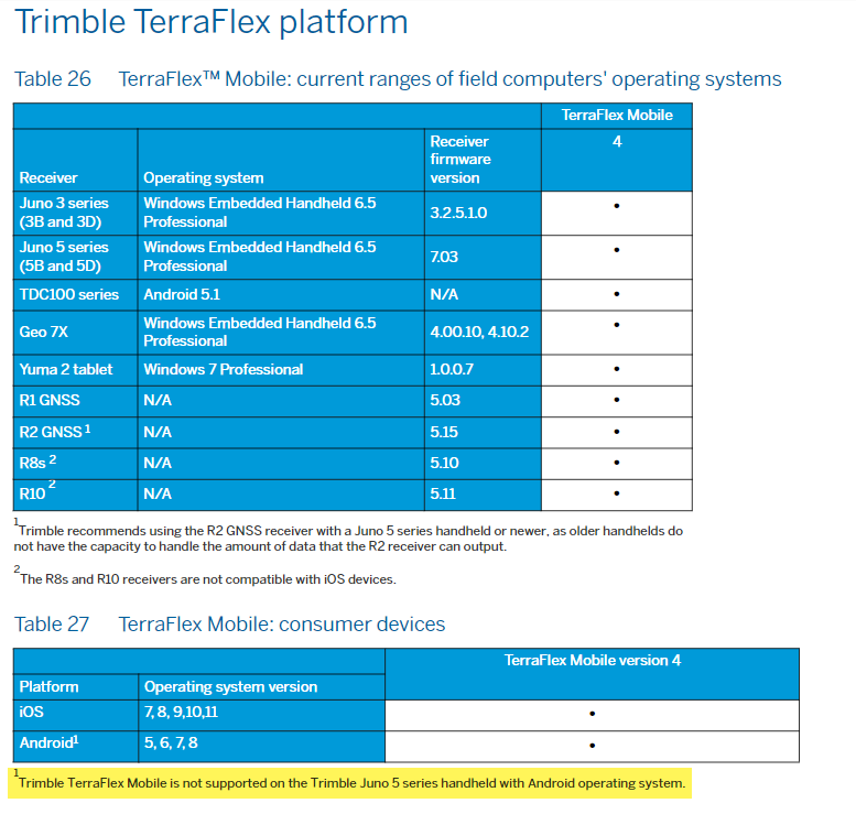

    Hi Vaileth,
    TerraFlex is not supported on the Juno 5 (Android) platform. Here is a link to a compatibility matrix and screenshot below confirming this combination is not supported.
