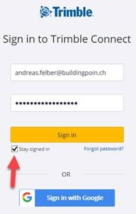

    Install Trimble Connect Desktop. You need to have internet connect when you log in, but if you use the "Remember me" option in the login form, you should be able to run Trimble Connect Desktop just fine with out connection.

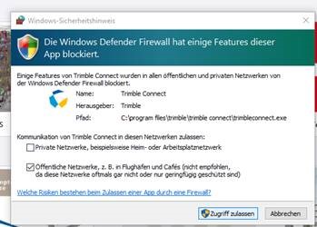

    I can tell you the following.
    The offline operation works as long as you have downloaded the data completely.
    • If the computer is not connected to the Internet with the Lan or WLan and you start Trimble Connect Desktop, the Windows firewall will ask for permission first.
      Give it access.
    • Trimble Connect Desktop will then notice that it doesn't have an Internet connection and ask if you want Trimble Connect Desktop to switch to offline mode.
    Confirm this and you can view all downloaded projects normally.
    Sorry, the print screens are all in German!

    Hi Daniel,
    As replied above, Trimble Connect Deskop can be used in offline mode for some period of time. You need to first log in with the "Remember me" checked while you have internet connected.
    We have no plans to make changes in the offline mode.
    Hopefully this helps.
