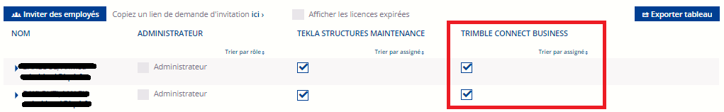

    You must be under a 2020 maintenance agreement to have a Trimble Connect Business license, which appears to be the case in your capture.
    Also make sure that the Trimble Connect option is checked as in my capture (last column).
    If the problem persists it is because there is a problem with your account (email) which remains in "personal", then I invite you to contact your Tekla reseller directly.
