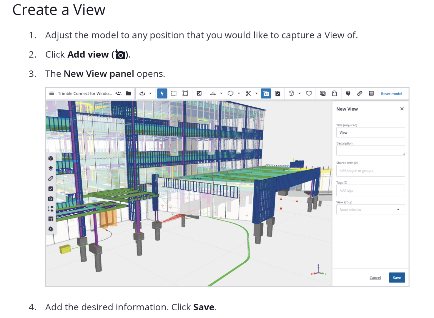

    The color changes can be saved in two ways:
    1. Use of the Status Sharing Tool (this requires a Business Premium license) - please see this video on how it works: Workflow Tools: Status Sharing Monday Minutes - YouTube
    2. Creation of Views in the Browser, Windows or Mobile applications.
      1. When creating a View, the 3D view and its content is saved. This includes the following:
        • Camera angle and zooming
        • Color and transparency changes
        • Object visibility changes
        • Measurements
        • Markups
        • Clip planes
        • Grid visibility
        • Clashes visibility
        • Ghost mode
        • Orthogonal/Perspective mode
    Create a View in the Browser 3D Viewer:
    During the View creation on the Browser's 3D viewer you can share it with other project members.

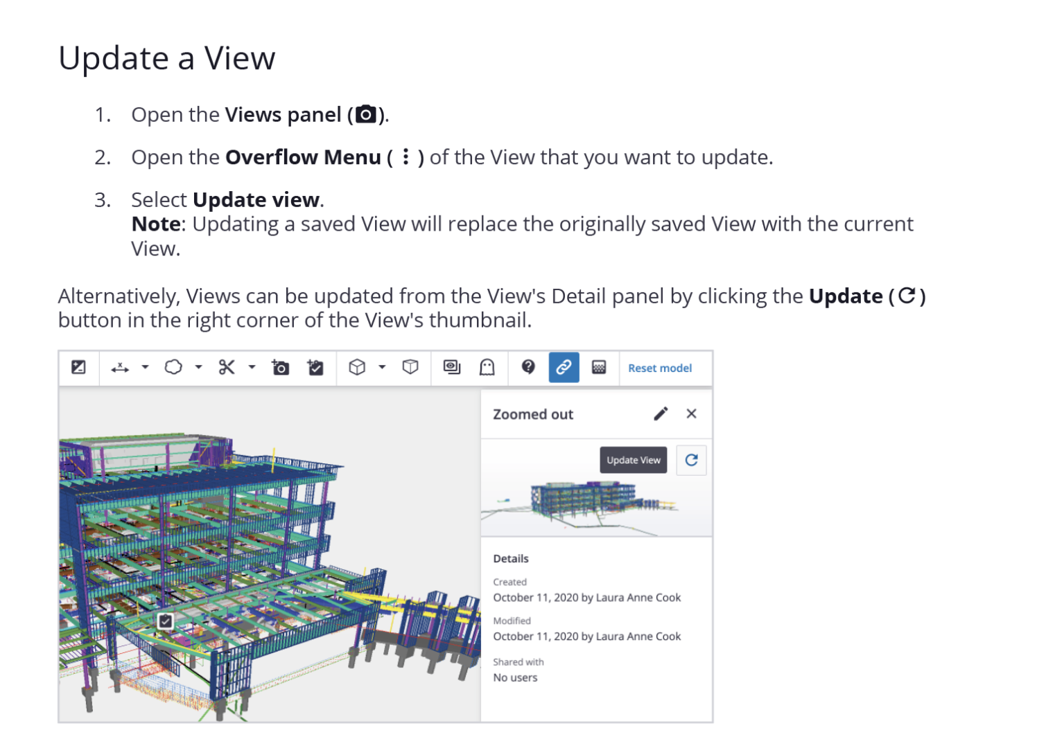

    To update the view:
