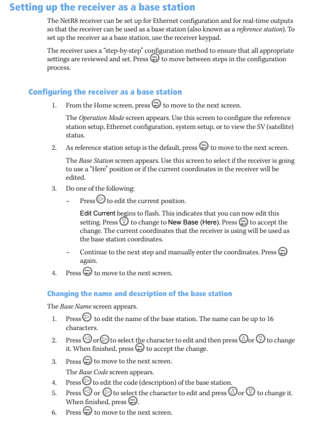

    Hello. I purchased in December 2017 two Trimble R8S receivers, one set up as Rover and the other one set up as base. I currently need two rovers, so I need to set up my base to work as a rover. I asked this question two days ago on this forum, but it doesn't show anywhere.
