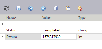

    Thanks for the reply! I've tried to configurate the  UDAs, but if i make a Status date the UDA show only numbers. I can't change the type anywhere. @Alexandre Collin

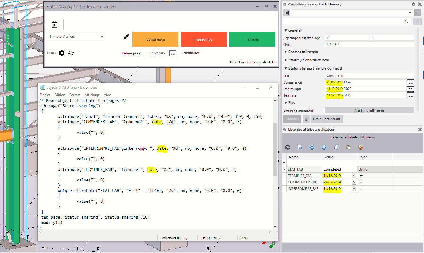

    I think you should change the field type "string" to "date" in the object.inp
    Look at my capture.
  • 6.  Re: Is it possible to get an report from Trimble Connect Status Sharing 1.1?
    Posted 12-11-2019 06:48
    Thanks, its working! Is there any possiblity to create an template for status sharing, like standard Assigning UDA when an new project is created (using a project template).
