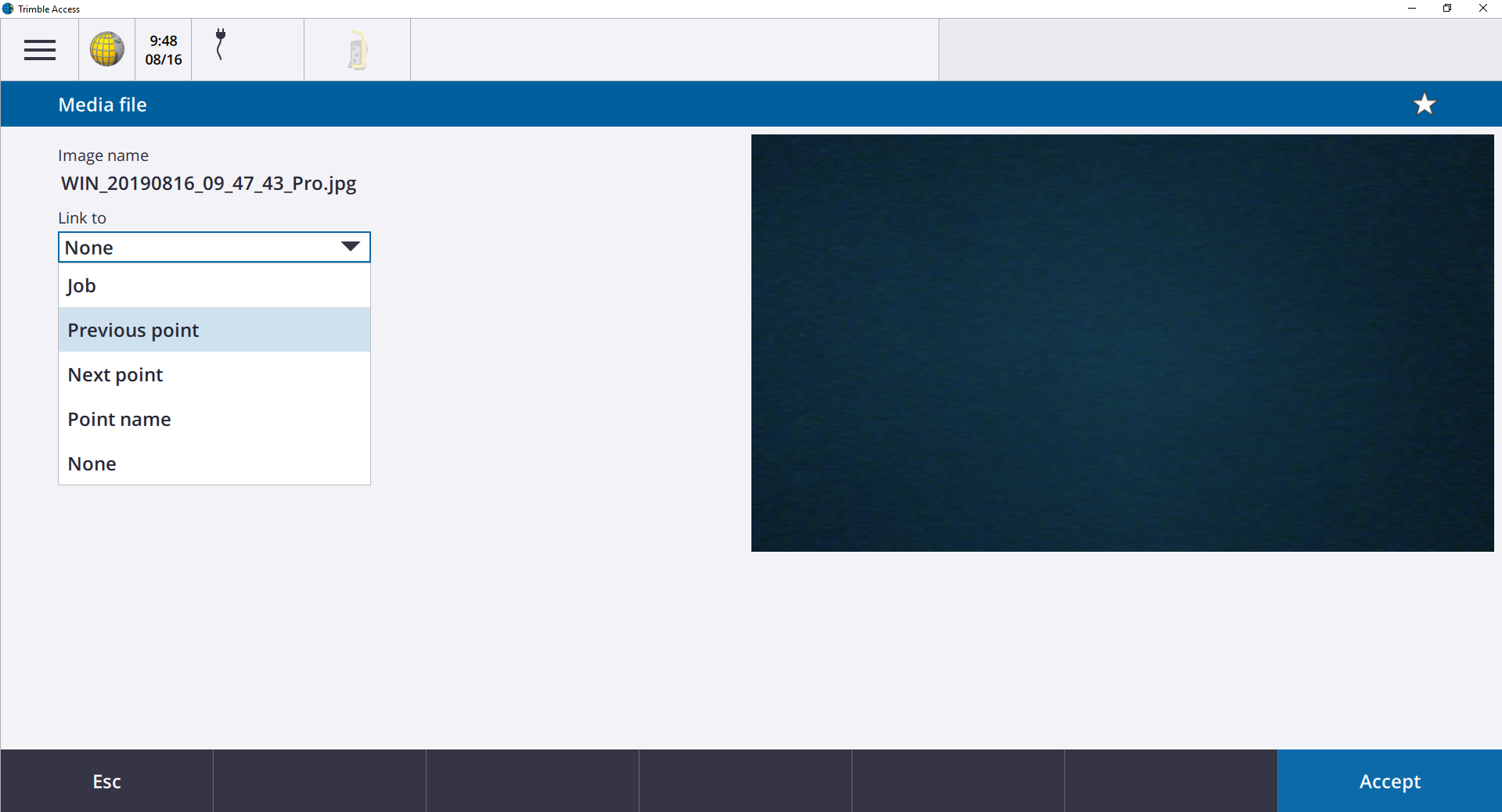

    Is it possible to change the default saved photo location on the TSC7 from Camera roll to C:\ProgramData\Trimble|Trimble data\Projects\?  When I select in "Settings" Change where new content is saved and select the drop down beside New photos and videos will save to: , I can only select This PC(C)

    Hi David, are you using the TSC7 camera for taking photos in Trimble Access? If that's the case, the photos are by default linked to a point or a job, and they will be stored in your project folder already, so you won't need to configure it at Windows level.

    They are using Trimble Access.  I talked to one of the surveyors and he said that he does not have that screen show up.  He has not seen it before.  How do you get to that screen?

    Hi David, during a usual measurement workflow, you may tap the camera button on the TSC7 keyboard and take a photo. Then the TA screen above will prompt.

    ...and one last thing I do after that is then is to tap over onto the TA screen once the photo is taken. Then you'll get the prompt for where to associate that photo with.
