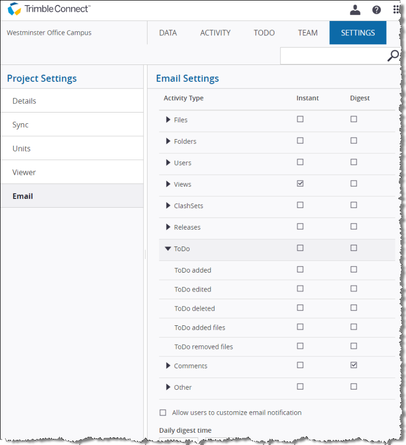

Several people in our projects receive more then one notifications on a ToDo.
  • 1.  Several people in our projects receive more then one notifications on a ToDo.
    Posted 01-12-2017 06:48
    Is this a E-mail setting?

    Hi Patrick
    ToDo notifications are configured in the Project SETTINGS page and will be sent to the users assigned to that project.
    You can have users notified on the ToDo action (Instant) or based on a daily digest time (Digest)
    If you are receiving duplicates for a single action, first check whether you have both an Instant and Digest notification set for the same action and disable one.
    Otherwise reach out to connect-support@trimble.com who can help you in more detail
