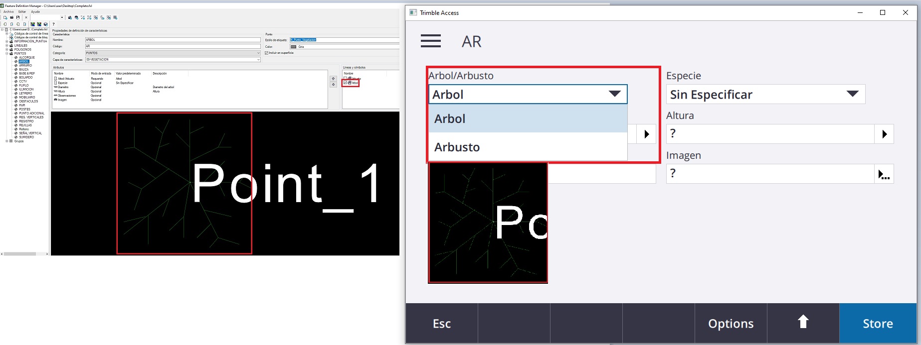

    I'm developing a plugin or extension for TASDK (and already watched all the youtube videos by @Nico Becke  ) and im trying to change the type of input (see the image adjunt) right now it is a text that is export from the Feature Definition Manager.
    I want to know if its posible to change that kind of text by an image or the symbols modificating the Code with the TASDK or I have to change it from the Feature Definition Manager Code? Is it even exits? Some kind of API or SDK but in Feature Definition Manager…
    And the other option or question is if I have to modificate the Feature Definition Manager code to change this code line that the .fxl archive send to Trimble Access to read it the type of code or symbols.

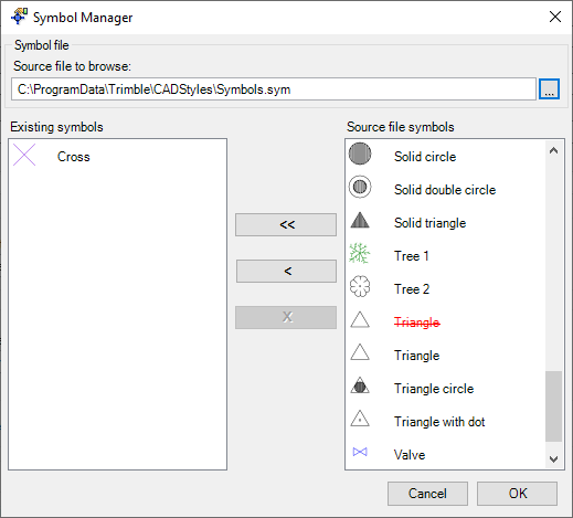

    Symbols are pre-defined drawings - usually imported via a 'sym' file or dxf etc. The screenshot shots the default Symbols file shipping with the Feature Code Definition Manager

    So if your symbol library contains different symbols for trees you can change the feature code of the point to switch from tree symbol 1 to tree symbol 2. But it will still be a symbol - no real-like photo.
    The photo gets referenced in the job file (so the path to the jpg is recorded in the job/ jxl).
    In the end you can have multiple tree symbols - and maybe try to make them more 'real life' likeish. But afaik you can't load images into a symbol. Plus those images would also not be shown on the map. So maps are usually tuned to show lightweight symbols (for performance) - they don't load images... At least not in GIS/ survey type of applications (not talking about Google Maps or what so ever).

    There's a chance on TASDK to show the default symbol on the submenu on Key in point "Code".
    Right now it shows the complete word "Arbol" -tree- (see the image) so:
    - Is it possible to change the visual mode?
    Change the actual visual as it is the word "Arbol" by the default Symbol - Arbol symbol-  that is generated by Feature Definition Manager? Do not show the word "arbol"(tree) , just show the tree symbol (as showing the iamge below, the trimble Acess one).
    ( I hope the image completes the explanation)
