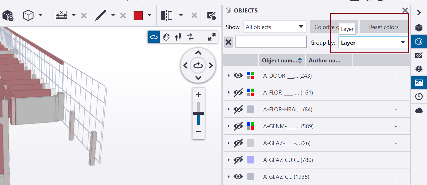

    My team has recently started using Trimble Connect to help with the steel erection process. We've found that our field management has the ability to hide specific layers within a single IFC, but we can not find the ability to do this in the desk top app.
    This functionality would make it much easier to isolate certain sequences of work if we could do this in the office.

    Hi Sam,
    The Connect for Windows (Desktop app) does have the ability to display and hide/unhide layers from the right panel . A screenshot is given below -
    Please let us know if this helps or you are looking for something else.
