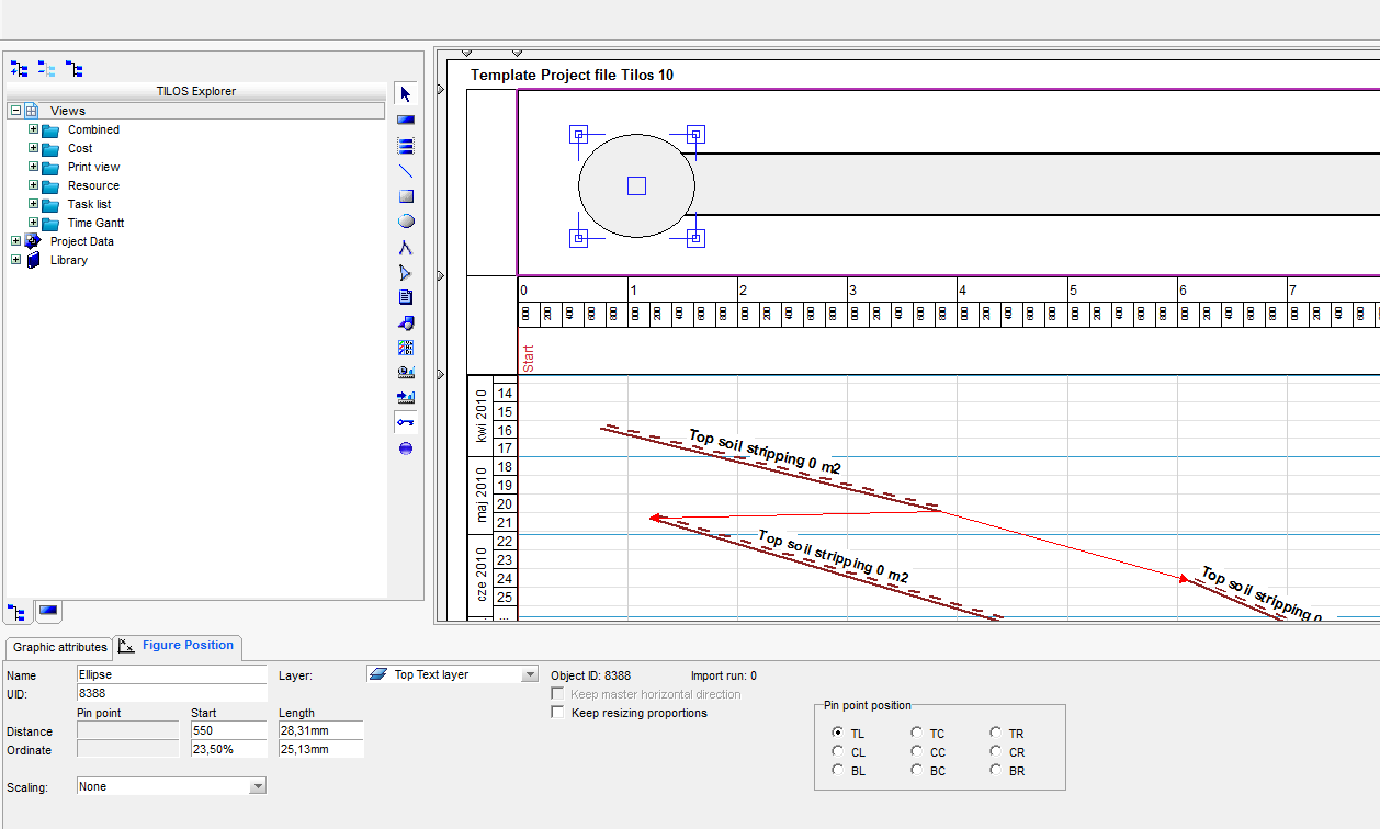

    when I check the Distance axis Descending option, the graphic cell on the top get mistake show. when I uncheck the option its shows correct.
    It appears stably. It's a Bug?

    Each graphical object has a Scaling property. If this property is set to None, then that parameter of the object is independent of the cell setting; the object's position is fixed, not adjusted to the ascending/descending setting, and not related to the cell size. This is not the same as when Scaling is set to Location.

    I have set the Y-axis scaling in the cell. For detail, I just set the end value to 2000. If this value is not set, resize the cell will make the graphics go away.Recently, I have changed the working computer to which used to my colleague's. So, I have TILOS license now. But, I new install the new 10.3 TILOS, the WPA function could not be use. But the function could be use in 10.2 version. I test in 10.2 version and found that it is almost similar to 10.3.I have create 3 tasks in the project. Until the show time during 3rd task, the graphic will show like in 10.3. So does the resize situation.
    The project add in attach this time. But the project is build in 10.2 version instead 10.3.

    Thank you for sending your project file (the one attached here is for your other WPA bug report). When we open it, we see that the Scaling option (bottom left) for the selected shape is set to None. Perhaps you were thinking of the cell scaling? Please select an option (Time axis, Distance axis, or Both axes) for this Scaling setting to see if it achieves your goal. Thanks.
