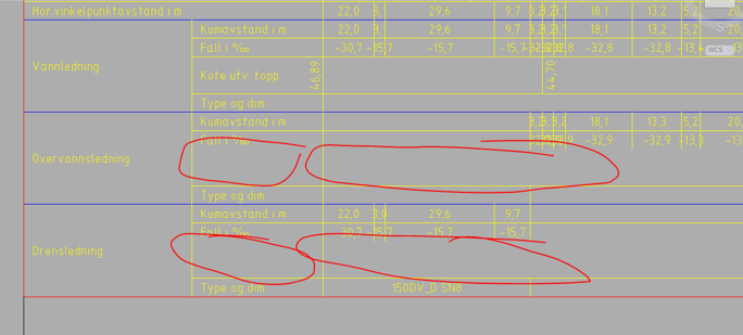

Problem
all Z-values for some of the pipes are missing!
Solution
In the example above, the pipes and “bend” as connection points. And in this case you will experience that Z-values are not shown if this box is unchecked: “Vis høyder på bend” = “Show Z-values in connection points)
