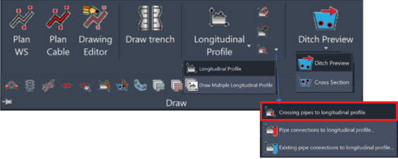

Where
You find the function in the following location:
How
The following method is used:

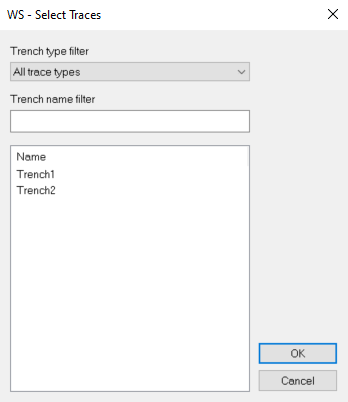

  2. The dialogue "Select traces appear"
  3. Select trenches with pipes that cross. ctrl + leftclick two or more trenches
  4. End with OK
