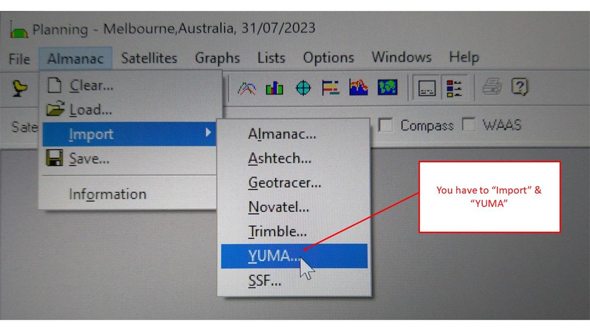

Sent: 08-21-2023 20:05
From: Joel Cusick
Subject: Adding Obstacles in Trimble GNSS Planning Online tool
So, John solved a YUMA file from USCG with a trick to find an almanac without TBC, or a WEBgui on an advanced receiver.
Trimble, could you respond with maybe a response that maybe this is a good idea, and reply with a suggestion on how to elevate the online GNSS processor to offer obstacles, and at the same time access to an almanac file.
The reason for this post.......
Joel Cusick
Sent: 07-31-2023 18:41
From: John Winkler
I don't think we are going to find Almanac files with the other constellations standardized in a Planning compatible format.
Other industry tools and software ingest the separate constellation almanac files directly and individually as the files are all different. Some almanacs are text based & some xml, the content and data field layouts vary, orbit geometry definition can be different, and even if the same, the units can be different, for example GPS YUMA angles in radians & Galileo files in semi-circles.
I think the suggestion is a good one, it would be most useful if the Planning web page could be enhanced to include both:
- Obstacles
- Option to download a consolidated ALM to enable offline use
John Winkler

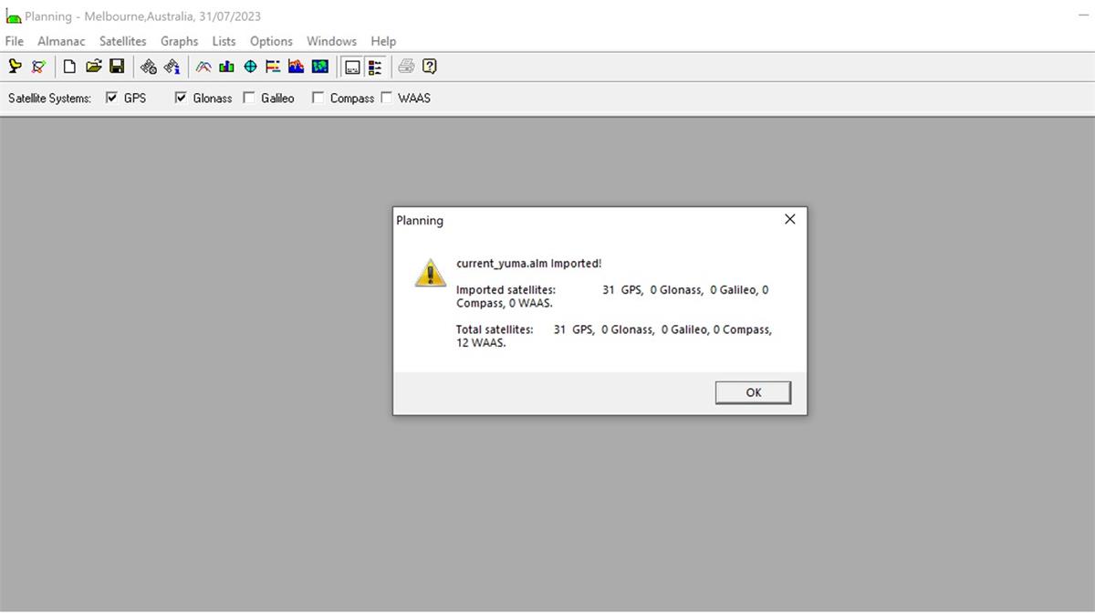

Sent: 07-30-2023 17:45
From: Joel Cusick
Hi John,
Ah, there. Thanks for the NAVCEN link. GPS only is fine for OPUS sharing, but like to have all constellations. I also tried the link, Loaded the current alm into Trimble Planning tool and no GPS sats
Accessing an almanac is possible thru the WEB UI on R receivers (I haven't tried an R7, but R10 etc). I can also access Almanacs from TBC. But what I think others (like you and me) would enjoy again is a Trimble site hosting daily all-constllation almanac's to run inside the Trimble Planning tool (without the need for connecting to a receiver or sparking up TBC!.
The online planning tool would be a great place to expose the daily ALM (say up in the upper menu /Almanac/Download.
Thanks John. Still seeking a online download site for full constellation ALM files.
Joel Cusick
Sent: 07-28-2023 07:09
From: John Winkler
However the only location I've found for Glonass is to FTP from here: ftp://ftp.glonass-iac.ru/MCC/ALMANAC but the file format isn't consistent with the available import options in Planning.
Which receiver are you obtaining the Almanac from? In Data Transfer I can choose file types of almanac or ephemeris and see them both sitting in an R7 GNSS....but when those files are selected they don't actually transfer, it simply times out & errors. The .T02 data files transfer fine (as well as the config files with the other utilities) so everything is otherwise working ok.
John Winkler
