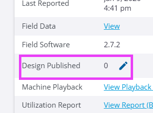

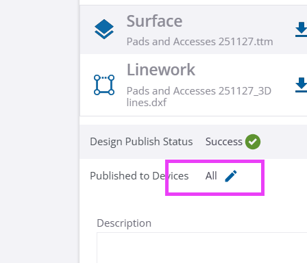

    It is possible since pretty much the beginning, very cumbersome, but possible.
    I just went to our companies WM, and the webpage still looks the same school kid after hours project, as it did years ago.
    I also went through the old posts here on the forum. The topic, about pushing designs in groups, as you requested, i.e. groups "experienced", "unexperienced", "graders", "dozer", came up again last year 01/2025.
    See my post #3 here from 01/2025, which is referring to my post #8 here which is from 01/2022!!! This is not a typo, it is from 4 years ago. You can see how good those WM guys are. They are fighting with the TBC guys over the "ignore the customers as much as possible" trophy.
    It's still only possible the old, cumbersome way.
    Either go to designs, click on a design, and in the right properties pane click edit "published devices"
    or got to devices, click on a device, and in the right properties pane click "published designs"

    Yes.  Add your devices to the project first then add your designs to WM.  Before accepting, there is an publish to all switch, or you can assign to individual devices.
    Clarification to this.  It's best practices to manage the devices, including machines and controllers through TBC.

    Thank you, Matt and Ronny. Trimble Support emailed me and explained that the option is in WM under either Design or DevicesEdit Published Devices. I honestly can't believe I missed that in WM after using it for so many years. It's good to know, and thanks to Trimble for pointing it out.
