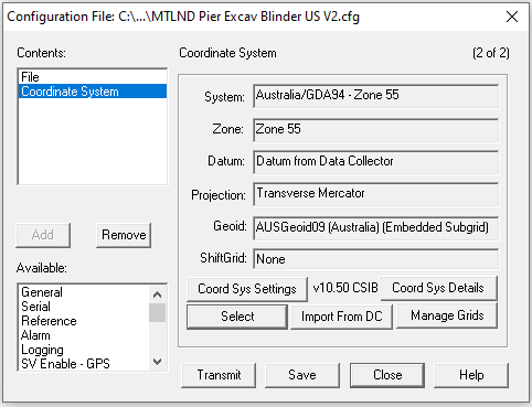

It's not just the GCS version you need to lookout for, also the receiver.
GCS900 from around 12.6 should be fine.
12.4 definitely doesn't work with cal and MS990 also won't work with it. Even now we had machines with that kind of gear coming to our site. So, we actually had to upload a CFG to Worksmanager.
One benefit of the CFG is that it contains a partial area of the geoid, you don't need to upload the whole geoid file, although Worksmanager is putting it on the TCC server nonetheless.
The CFG is not just used to set the coordinate system, it's a general configuration file for the receivers. You can set input/output data streams etc. which are activated/executed on startup. (Trimble Access will overwrite those settings if you use the receiver with it again, was a bit of a bummer when I tried to upload a permanent file to a SPS785 that we also wanted to use with our line marking robot)
i.e., when you set a proper coordinate system and output serial ports in a CFG you can get final local coordinates out of the receiver as long as you feed a NTRIP stream into it, no additional software required.
You can look at the content of the CFG with the old Configuration Toolbox.
https://forms.trimble.com/support_trl.aspx?Nav=Collection-49573&pt=Configuration%20Toolbox
