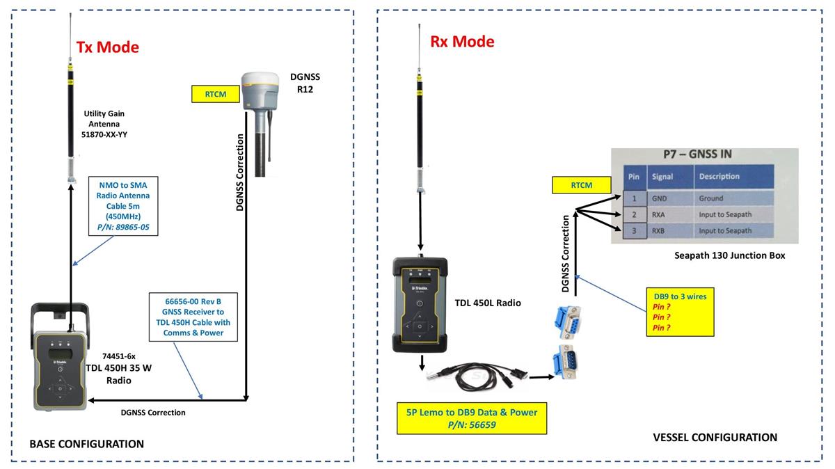

    Hi James McWha,
    Thanks for your kind comments on the issue.  In that case, can we have the arrangement as shown below.
    R12 - Seapath RTCM Integration
     If so, I need your kind answers on following:
    a)  Do we need to configure in RTCM format in both Radios as well?
    b)  How can I get the pin configuration information of the Radio Data Output Port?
    Best regards.
    Commodore Zakiur Rahman Bhuiyan (Retd)
    Advisor
    OMC Ltd, Dhaka, Bangladesh.
  • 4.  RE: Can R12 in Rover mode provide CMR or RTCM output?
    Posted 07-02-2023 16:12
    You would be best contacting the manufacturer or distributor of the Echosounder for details on how to connect the radio and what radio protocols are supported. Details on configuring the radio and port pinouts can be found in the TDL450 user guide. Regarding the pinouts for the cable P/N 56659, these should be the standard RS232 DB9 pinouts.
