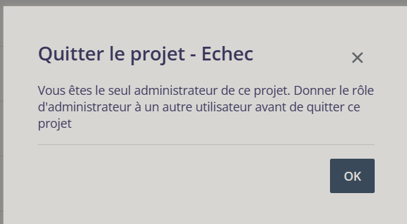

  • 4.  RE: Re: delete project
    Posted 05-09-2023 06:48
    Hi, deleting a project is not possible when you are the only admin?
    error messageI wanted to clean up my digital footprint, but with Trimble connect it is not possible because i work alone...?

  • 5.  RE: Re: delete project
    Posted 05-10-2023 08:11
    Leaving a project should not be possible if you are the only admin and there are other people in the project team. But deleting a project should be possible if you are an admin.

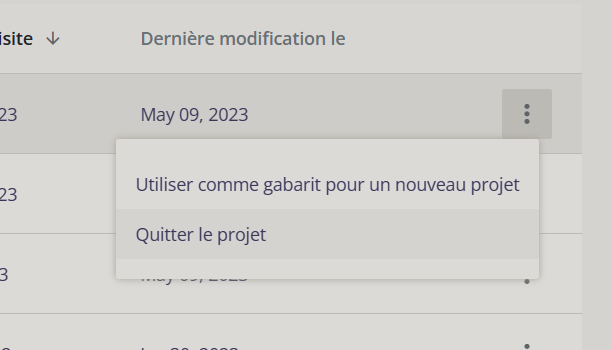

  • 6.  RE: Re: delete project
    Posted 05-11-2023 00:17
    thank you for the answer
    where do i find the option to delete the project?
    2023-05-11 09_12_23-Trimble Connect Web et 1 page supplémentaire - Personnel – Microsoft Edge.png
    i only have
    • use as a template
    • leave the project
  • 7.  RE: Re: delete project
    Posted 05-11-2023 00:40
    Hi Georges,
    Please find details here - https://docs.browser.connect.trimble.com/projects/leave-or-delete-projects#h.grm9n18qce75
    If you are unable to find this option  , please send details of project and your user ID to our Support team (connect-support@trimble.com) so that we can check .
