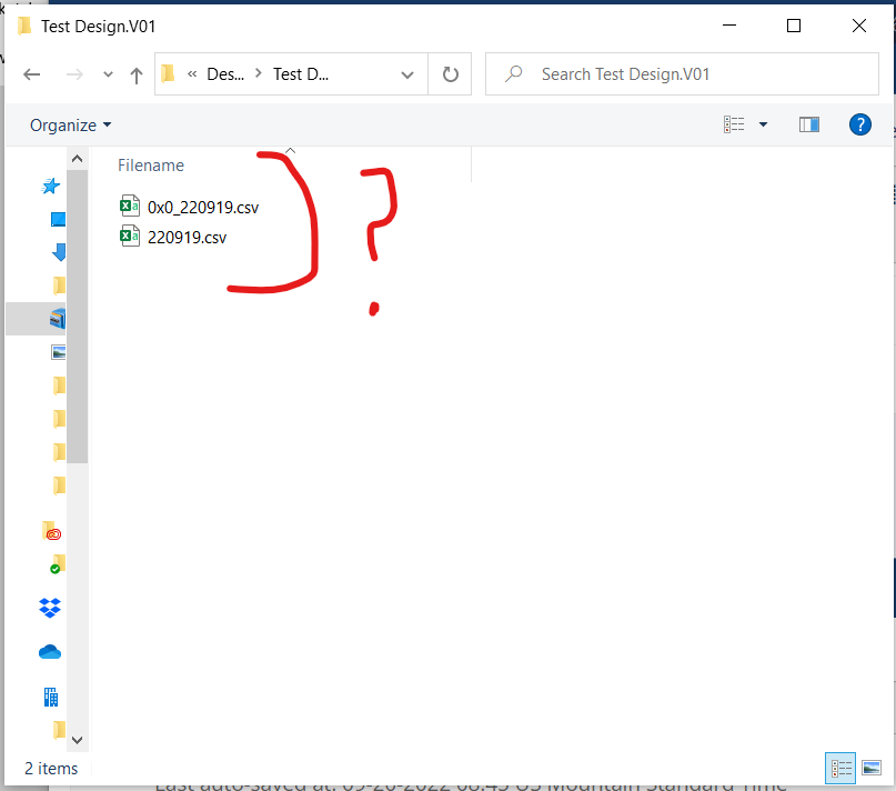

    When creating a design in WM using a stakeout CSV, TWO CSV files show up on the controller.  Is this happening to anyone else?

    SOLVED:  Please note that if you use an underscore _  in the point name, Worksmanager will create 2 separate csv files with one being truncated at the _.
