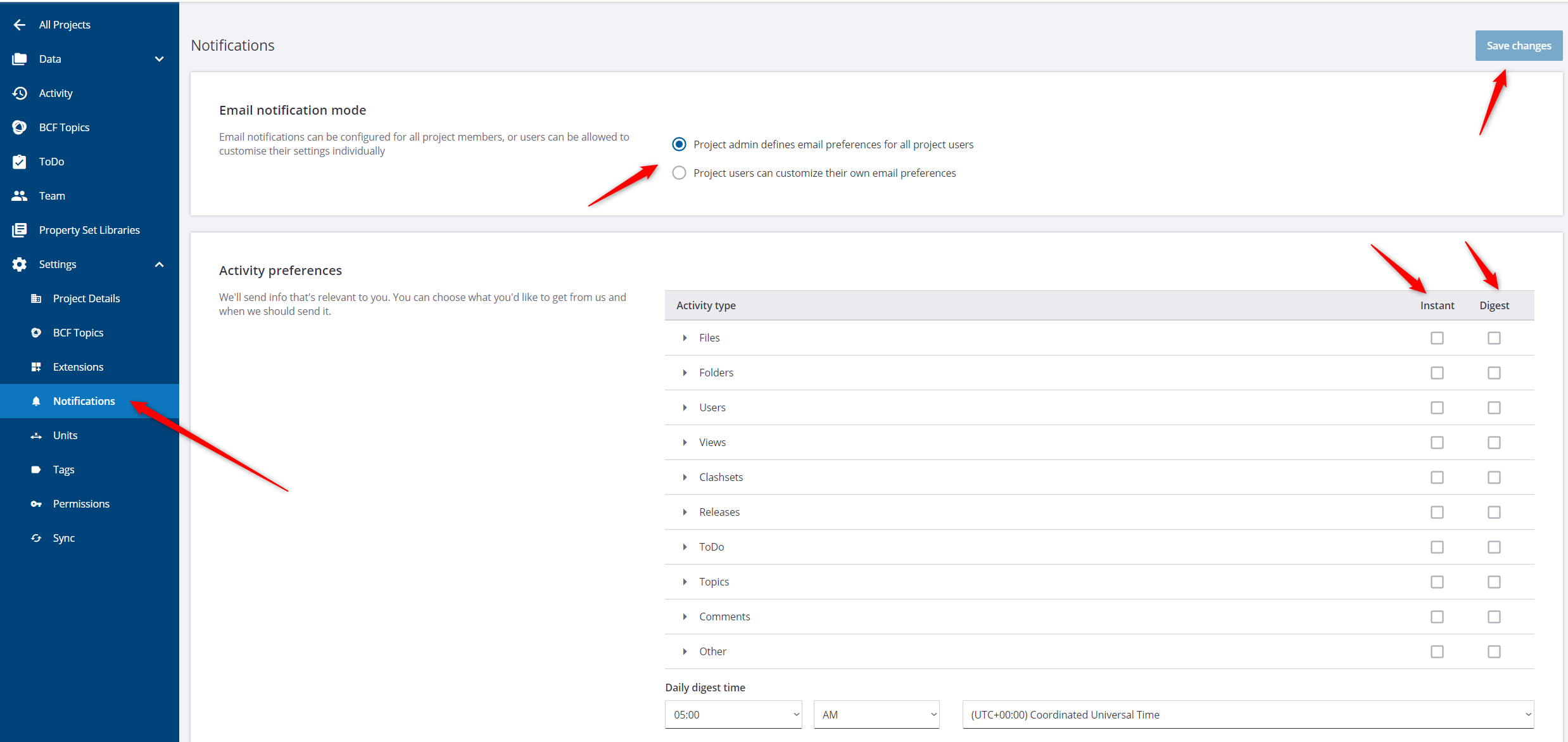

    Hi
    Try to check out your notification settings. Maybe project admin defined email preferances for all project users and that is the reason. If so, ask admin to change it in the settings and then you can choose which notification you want to receive. Do not forget to save your new settings ;)

    Users can customize email preferences : )
    But it does not matter anyway. For instance, Topic notifications should refer only to Topics related to a user. When a user decides to receive notifications about new comments, or Topic assignments, he should get them when they involve himself.
    Now he's getting notifications about every single Topic being commented on or created. What happens then is people remove all spam from TrimbleConnect including relevant notifications.
