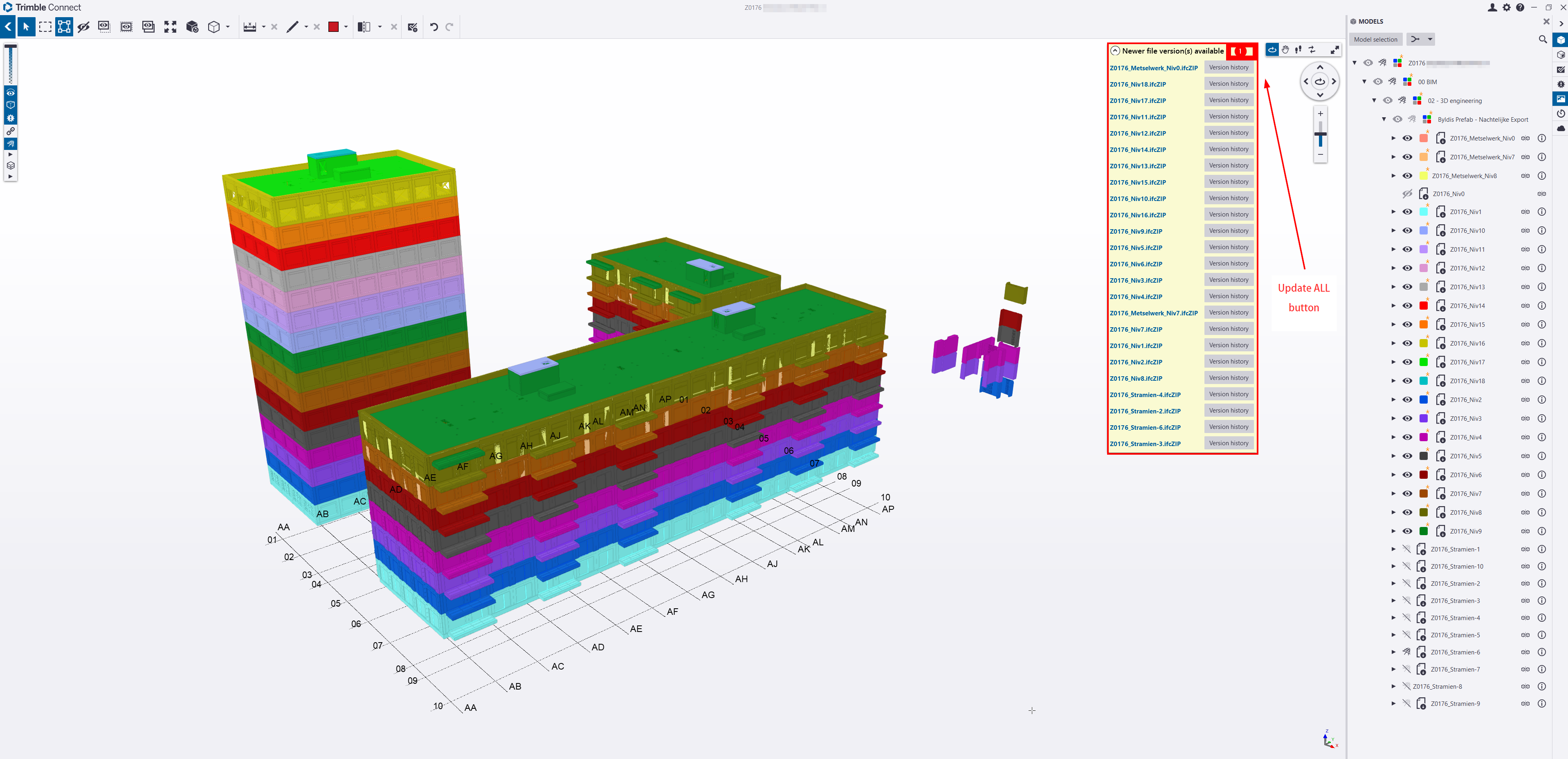

    Since a last update, we get a visual warning on the screen that newer file versions are available. This is very helpful. In our situation, we generate IFC files of our projects every night, separately for each level. Then to update all the models, I have to click on them one by one. For this, my wish is that there will be an addition within this feature. For example, an "update all" button. Make it visible only when you unfold the menu, then you know that the user has also had the list visible. A next step would be to use selections to quickly exclude one or more files. Then it becomes an "Update Selected". Can the displayed files also be classified according to the folder structure?

    In the meanwhile, I can think of a potential workaround that you perhaps could consider: If you create a view and then later open the view, it by default loads the latest model versions in it: https://docs.windows.connect.trimble.com/views/opening-views-in-3d#h.jtkw9mttc88l   For some users, this is a convenient way to load the latest model versions quickly.

    Thank you for your response, I am happy to share this with you. Good to read that this will be picked up. Your suggestion of a simple way to load the latest versions has helped us now.
