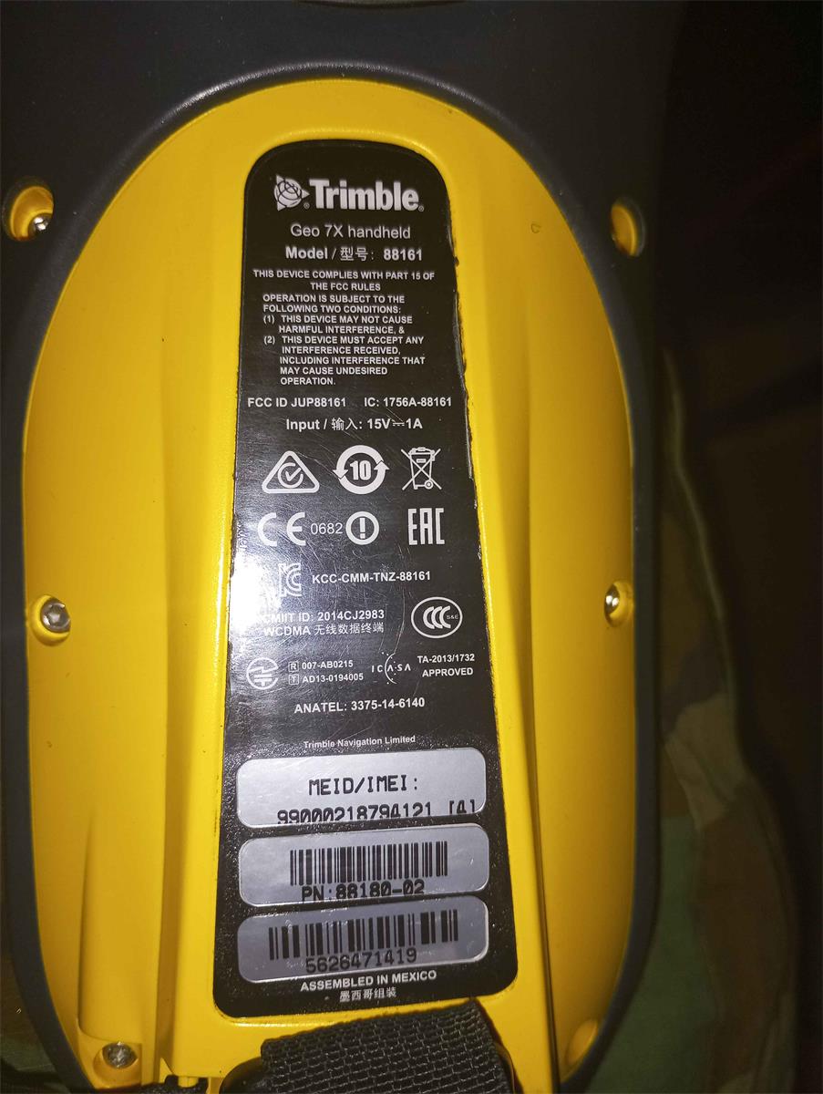

    I'll paste a photo of the nameplate, all the data will be there and it will probably be the most readable:
    Artur Artur

    The serial number comes up as "Trimble Geo 7X handheld (Floodlight, NMEA)" with no mention of H-Star or cm so indicates a base model with sub-meter. This would be consistent with the Tempest rather than the Zephyr antenna.
    As an example, my cm unit shows up as "Trimble Geo 7X handheld with rangefinder (Centimeter, H-Star, Floodlight, NMEA)".
    John Winkler

    As John gmail says in an earlier reply, your device is "Trimble Geo 7X handheld (Floodlight, NMEA)", that means it is single-frequency so changing to a Zephyr will not make any difference, it will give sub-meter accuracy.  You'd need to find a Geo 7x with H-Star option or CM option to give dual-frequency and better accuracy, and those would have cost more originally.
    If you find a Geo 7x which has the H-Star option turned on, that can give 10cm accuracy with Tornado or Zephyr 2 / 3 or internal antenna with appropriate corrections or using post-processing.
    If you find a Geo 7x which has the CM option turned on, that can give 1cm accuracy with Zephyr 2 / 3 with appropriate corrections, better than 10cm with other antennas.
    Upgrading an existing Geo 7x to add H-Star or CM option used to be possible but (1) you can't do it anymore because support for Geo 7x ended years ago, and (2) I'd guess even the H-Star option would have cost more than your second-hand Geo 7x cost you!
