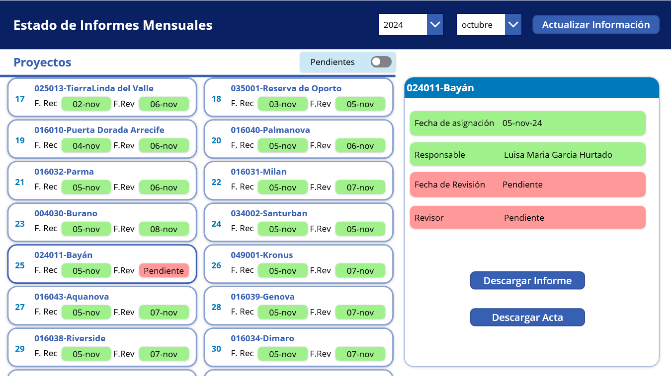

  • 9.  RE: Holistic view of ToDO's in several projects - BimManager
    Posted 11-25-2024 07:43
    Hi Marcel
    We achieved this by using Trimble Connect API integrated with Microsoft Power Apps.
    Next is an example of an app to check for each project an specific ToDo.
    On the left, the app lists all projects, and the right panel shows the details of the selected project.
    You can add buttons to perform actions in Trimble Connect, such as downloading a file, changing the status of a ToDo, leaving a comment, and more.
