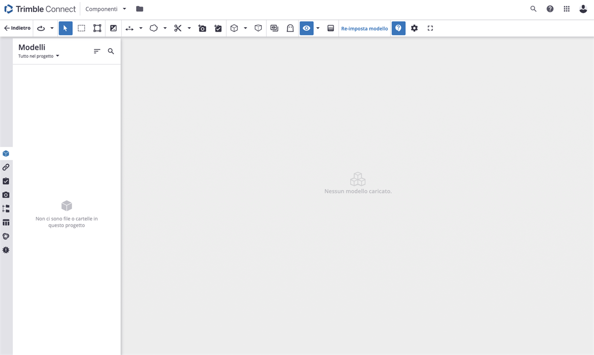

      |   view attached
    Hello but the problem is just that: where is the page?
    Where is the: "Project Details page"?
    I've been looking for the button for days and it's not there: watch the video I'm attaching.

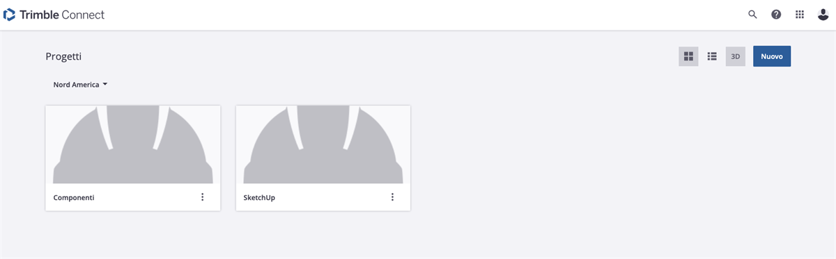

    Your problem is that you are opening your project straight to the 3D part of Trimble Connect, and there is another part where you have more management options. You can access the folder management part in 2 ways.
    • in your projects homepage, where your video starts from, there is a button on the top right named "3D", and it is turned on. iI you turn it off and enter the project, you are going to the data management part of Trimble Connect
    • Alternativelly, from the 3D, you have a folder icon at the top immediatelly to the right of your project name, that give you the option to go to the data management part.
    Hope this helps.
