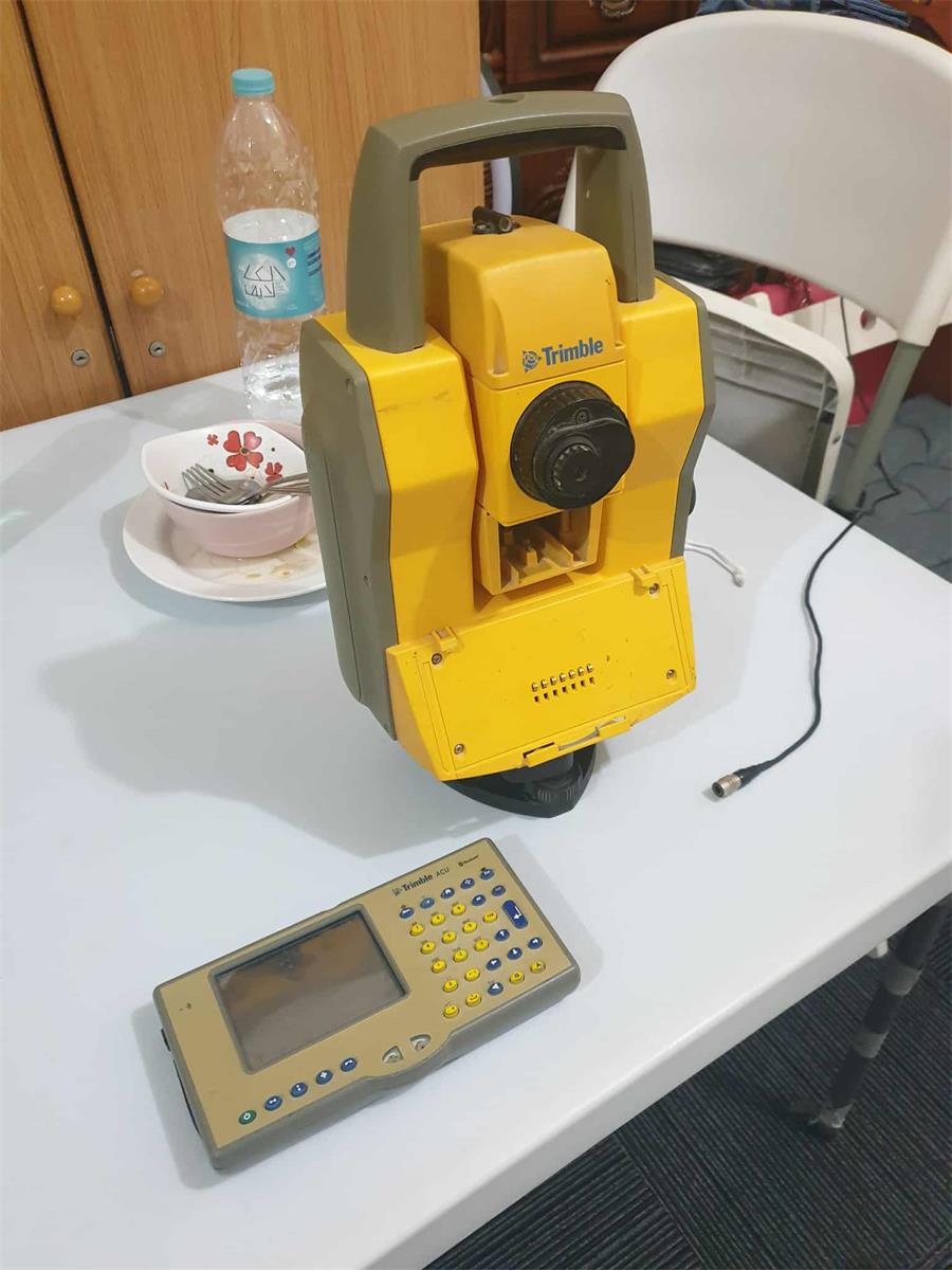

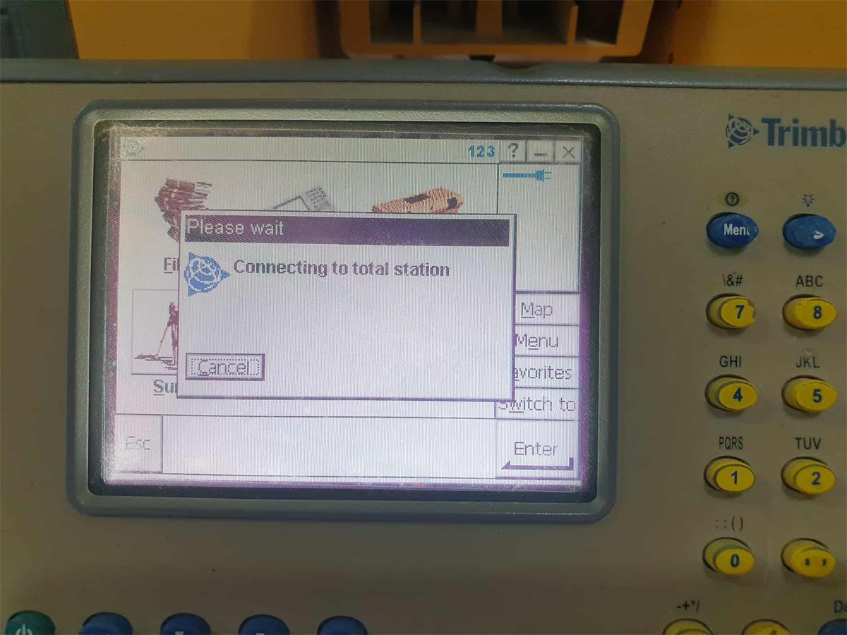

    hello sir i have a 5503 total station, i did not use it for a month, then it stop connecting to acu, i suspect the internal battery gone flat and the firmware maybe lost, i tried to go to service center but they say they stop servicing this unit a long long time ago. by the way im from qatar, anyboby maybe have copy of the firmware fo this instrument?
    trimble 5503 not  connecting to ACU
    not connecting
