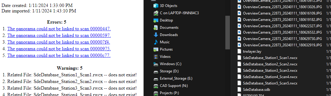

I do not see any filters on and we are unable to import scan data from any computer. The data is on CONNECT anb is downloaded using the ToDo option. I have to make a xxx Files folder and a SdeDatabase.rwi folder and put the files where they go, but this works.

My crew has SYNC'd up, but it took forever to get all the data and still the scans aren't linked. I used the TBC Connected Workspace, but there were files missing. I then tried using CONNECT on the web with the survey tools enabled, but I'm missing files. I then tried SYNC and did not get a file error, but the scans still didn't show up. I then used CONNECT on the web to download all the data from the TO DO option. I extracted the data and created a Files folder. TBC still says the RWCX files are missing, but I see them in my folder.
This is a major issue, how do I fix this problem?
