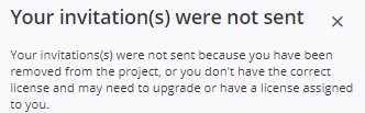

    Posted 08-16-2021 07:11
    Hi Darshan,
    Just reading your reply to Paul. I have a project with 6 users including myself and cannot invite another user. Getting this message:
    which sounds like b. in your description. Except that I have many projects. I have a Sketchup Classic Pro licence and am informed that I am then a licensed user. Can you please clarify. The Trimble storefront does not seem to offer any explanation for this.
    Kind regards, Greg
    Greg Killen

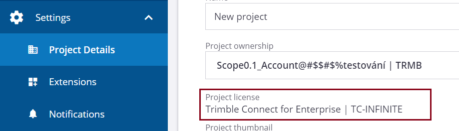

  • 11.  RE: Re: License of Trimble Connect
    Posted 08-16-2021 21:44
    Hi Greg,
    Could you please go to the Project details section in Settings and check the "Project license" (sample screenshot below) .
    1. If its Connect Free license, please update the Project ownership to your account with Sketchup Classic Pro license and save the changes. This should allow you to invite more people.
    2. If it already has the Sketchup Classic Pro license and you are unable to invite people, I would request you to get in touch with the Sketchup team. Its quite possible that they have set a limit of 5 invites.
    Darshan Rajaram Kamat
