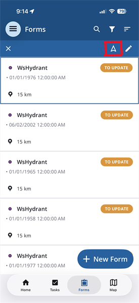

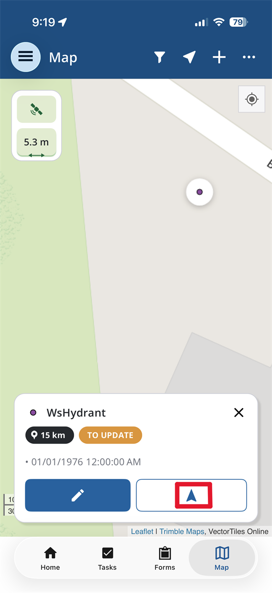

    If the point you want to navigate to is one you have captured in TerraFlex, then there is a navigation option available when the point is selected in the Forms or Map view.  This will start navigating you to the point's exact location.
