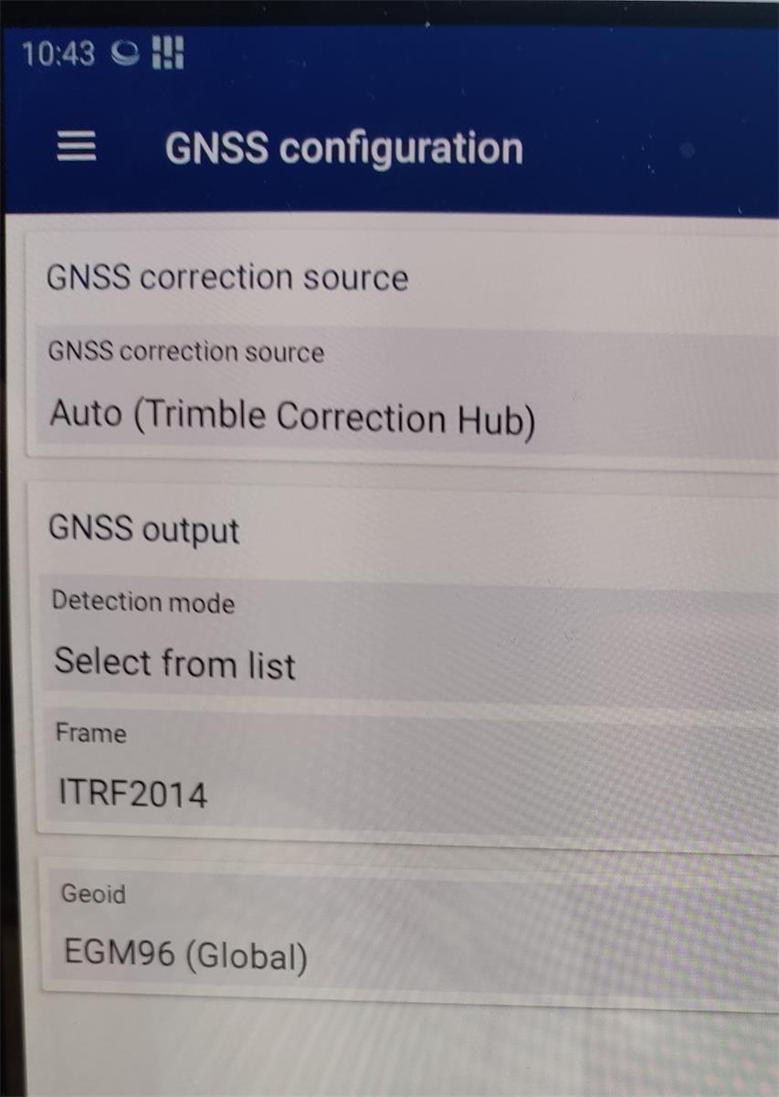

"Offsets" in data as you've observed are typically the result of differences in datum. Please confirm the datum of the brass cap and the datum of the collected data. Without knowing your method of collection with Catalyst, it's difficult to say what the correct configuration should be.
However, start in TMM and verify the "GNSS Output" datum selection. The default is "Auto" which will choose the most appropriate local datum for your geography. Choosing "Select from list" will allow you to specify the output datum - allowing you explicitly match the datum of your brass caps.

The update was installed now I am seeing the orthometric heigh but the accuracy seems to be off when data is captured. any assistance would be greatly appreciated.
