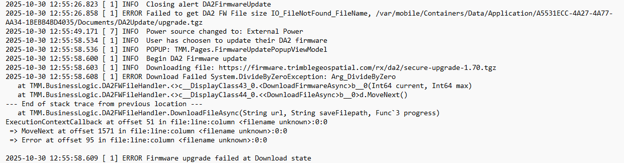

    Mark - the user tried a different Trimble ID but the problem persists. Snippet from log file below.
    I'm also told that there is no option to dismiss the firmware update, so the DA2 is unusable in its current state.

    Hi Jamie,
    The firmware update prompt doesn't force the user to update the device, it can be dismissed and shouldn't stop the user from working. For some reason TMM on the iPad is trying to download an old firmware version which is no longer there. In this cae, as it is only happening from this device, I would recommend uninstalling TMM before reinstalling. If your are concerned about the GNN configuration at all you can export that prior to uninstalling and import again after.
