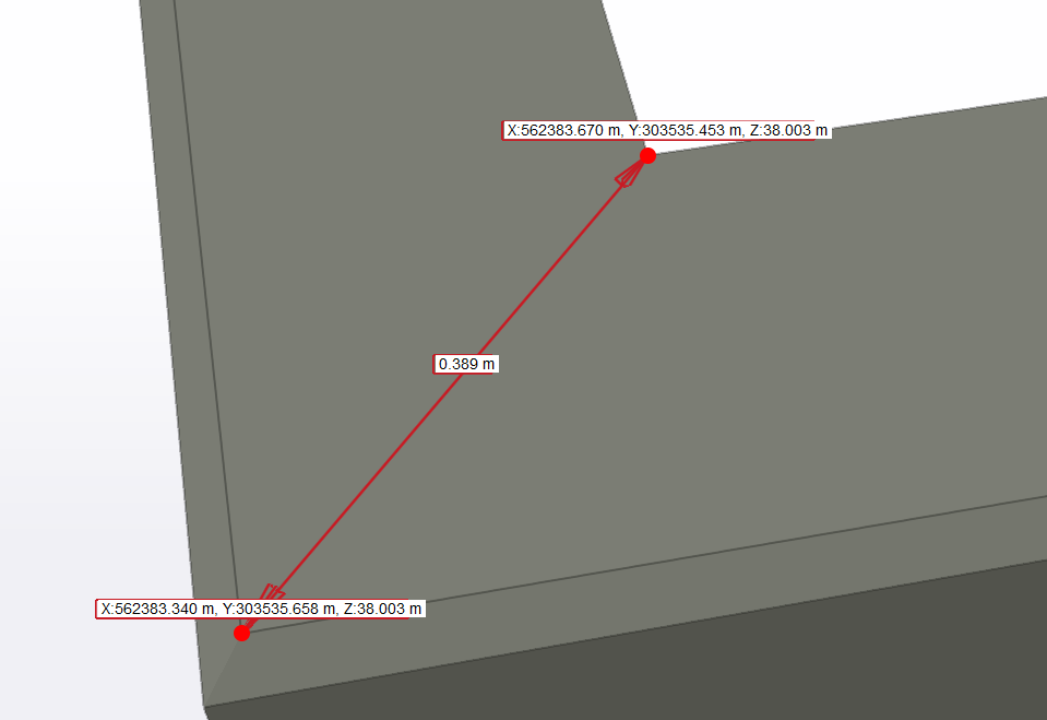

Hi , I have found how to see coordinates. Is there any way to get this into CAD or export all these points to a file.
