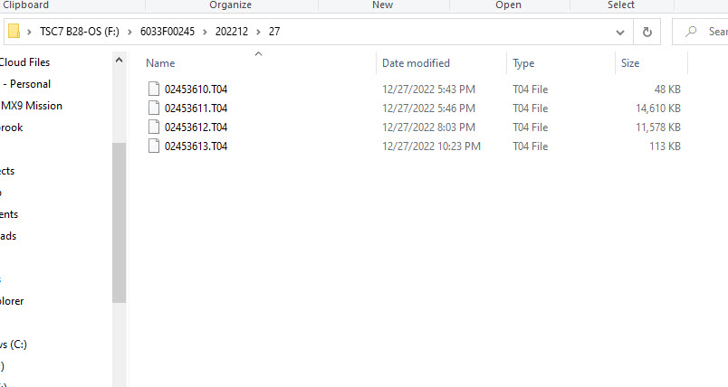

Sent: 12-27-2022 17:24
From: Joel Cusick
Subject: R12i Trimble Access Static File (T04) Bloat
Greg,
I replied too soon. In this case, using an R12i (your video was for an R12 without the IMU), the file transfer never concluded (waited over 15 minutes). The file was valid, only 2:15 minutes in duration and took over 4 minutes to transfer via bluetooth.
This approach appears not to work with a static file (T04 format) on an R12i.
Joel Cusick
Sent: 12-27-2022 10:32
From: Joel Cusick
Greg,
Excellent video. I did not know that the cadence change of the download light on the R12i panel that indicates all files are downloaded. This is by far the best approach for speed, with the exception of the WEBGUI approach that pulls down a T02 file.
I'm still going to keep this ENHANCEMENT alive - it would be prudent to offer a T02 option, which for a Static solution, say a 8 or 10 hour occupation means a 10x size difference. Why the WebGUI can do this, and not Access seems simple.

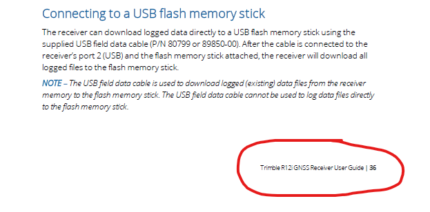

From: Greg Hazelquist
Subject: RE: R12i Trimble Access Static File (T04) Bloat
Hi Joel:
Here's a link to a quick video showing an alternative way to transfer static files from R10/R12 receivers directly to USB flash drive. Perhaps will help you out:
https://drive.google.com/file/d/13_nV9HtGtlfsNnYubKfXLQR8cb636re4/view?usp=share_link
