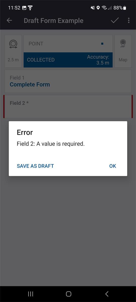

    Sounds like there might have been a field in your template that had the Required Field option enabled. Fields with this option must have a value entered before they can be saved and synchronized, you can identify them in the form by the * beside the field name. They might also have red bars on the side of the field to indicate they are in an error state:
    If you have a form like this then when you attempt to save the app will only let you save it as a Draft:
    You can find Draft forms in the Form tab on the home screen. You can open and edit the form, fill in the required field and then save:
