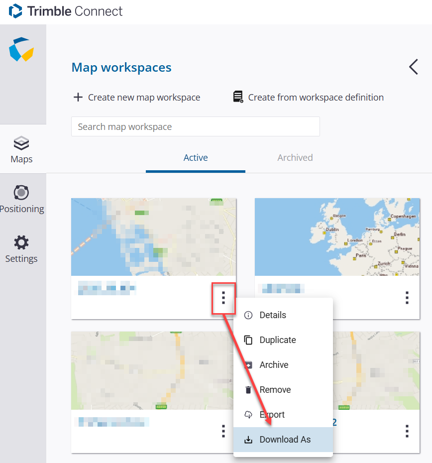

    You'll need to Download a Workspace Definition file (*.WSDef) which contains a copy of the form templates you can import into a new Connect project.
    • Open any Map workspace in the Connect project your form templates are located
    • Select the side panel
    • Browse to the Map Workspace you want containing the form templates
    • Select the 3 dots and hit DOWNLOAD AS... this guides you through the export so follow the instructions
    You can then create a new map workspace in the new project from the WSDef file which will import all the form templates into the new project as a new Map Workspace
    • Browse to the new project folder in Connect
    • Open any Map Workspace and go to the side menu (you might need to create one If there aren't any)
    • Select the 'Create from Workspace Definition file' option and follow the steps
