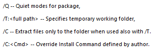

    I need the complete silent install argument for application : Trimble Connect Sync (TrimbleConnectSyncSetup_x64_v2.63.1.0.exe).
    Silent install means absolutely NO user interaction needed.
    The installer suggests:
    But when I try the '/Q' it comes up with:
    Please help?

    Extract the TrimbleConnectSyncSetup_x64_v2.74.3.0.exe using 7zip. You will get two files -> setup.exe and setup.msi
    Run setup.exe /q from command prompt and silent installation will work fine.
