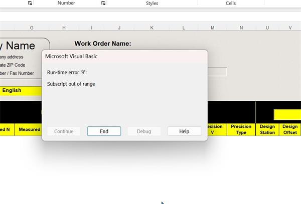

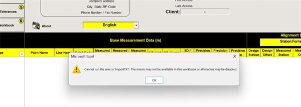

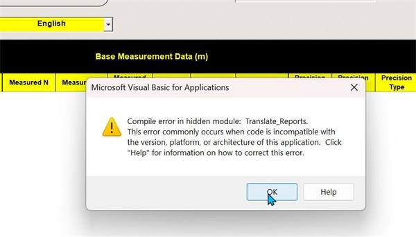

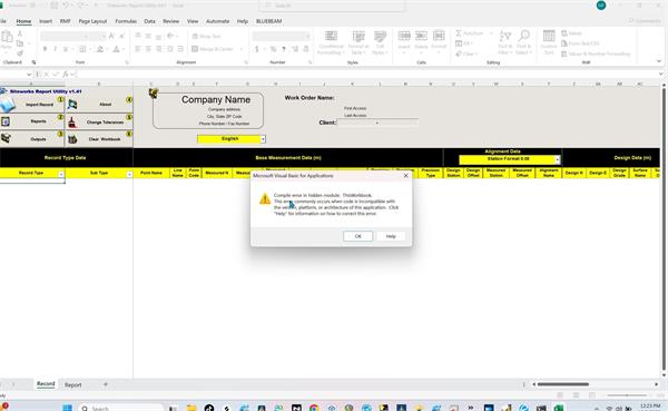

    I have been unable to use the Siteworks Report utility. Keeps throwing these errors. Anyone have any experience with this? I have Version 1.8 of the utility.

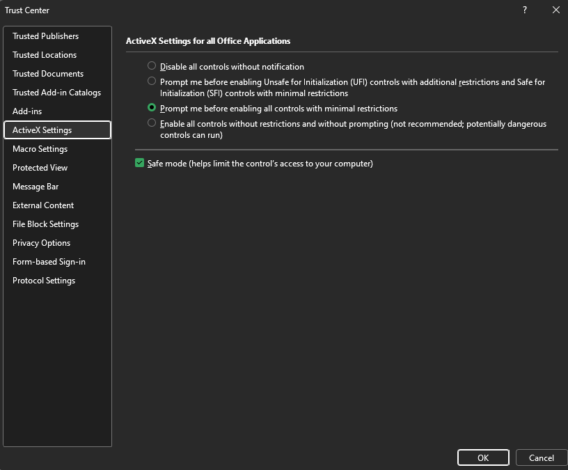

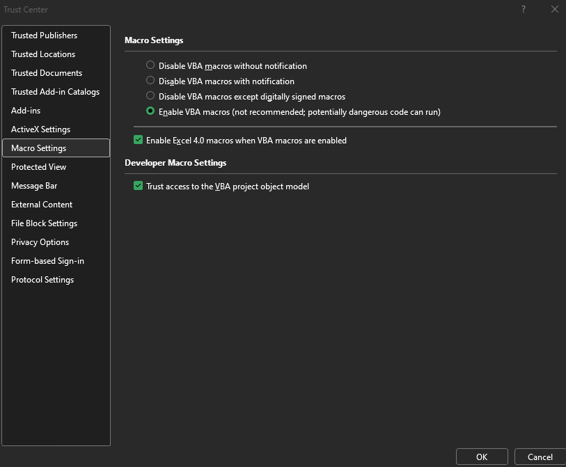

    These settings fixed it for me in the File > Options > Trust Center.
