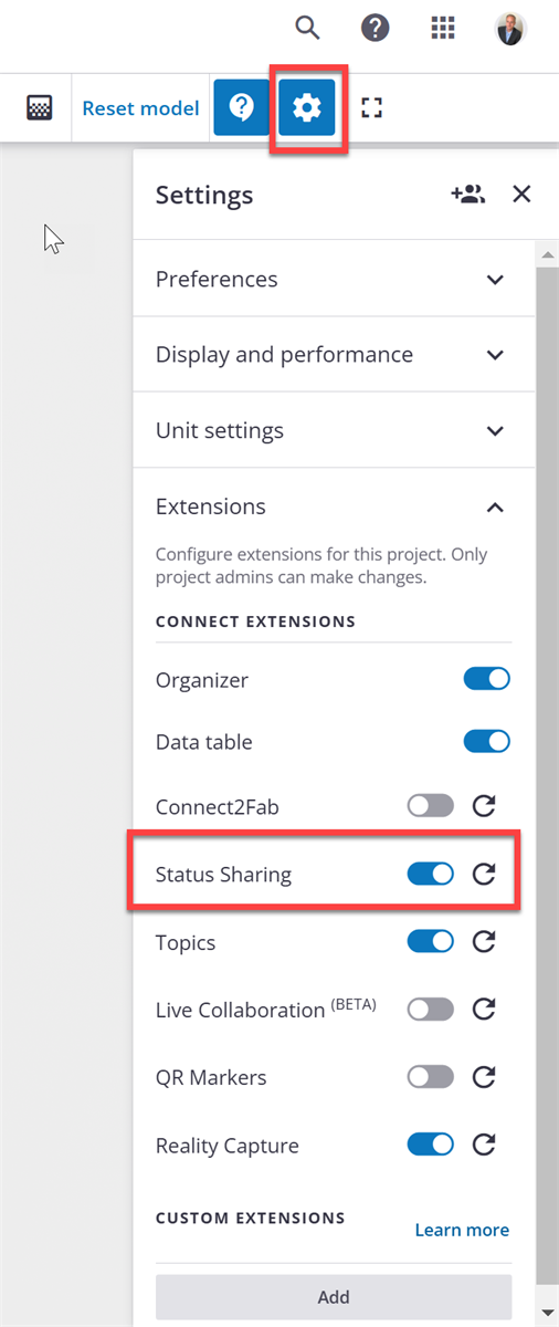

    Hey Piotr,
    Can you check that the Status Sharing extension is enabled in that Trimble Connect for Browser project as shown below?

    Hi Lee,
    I've checked the settings and you are right. The status sharing extension was turned off. It seems someone from my team had to mistakenly change it. Thank you for quick response. The issue is resolved.
