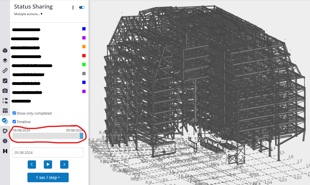

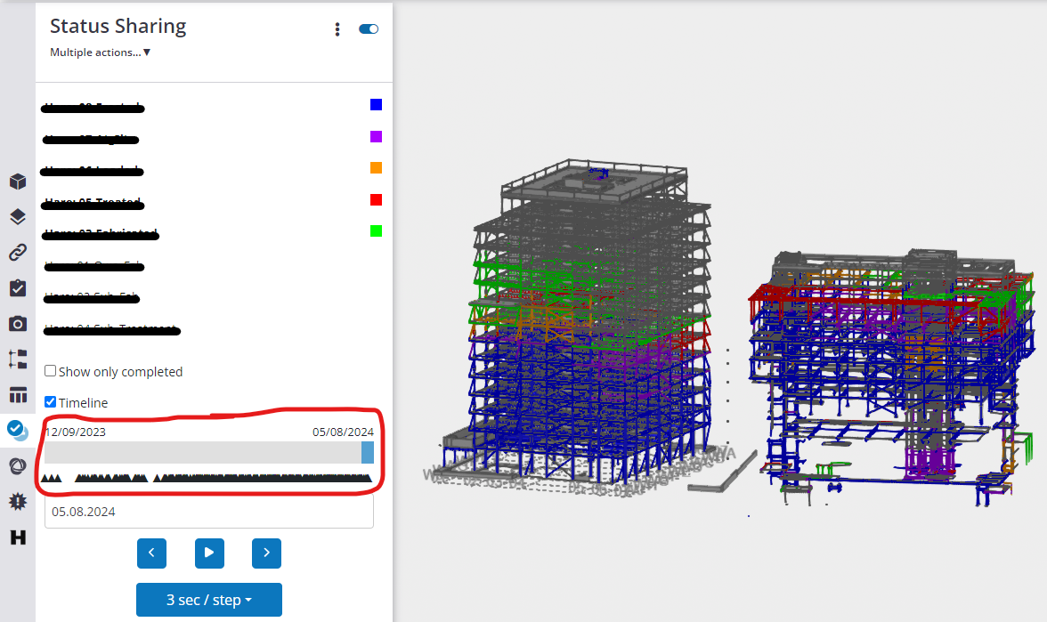

    I've noticed since Trimble Connect System Maintenance (07/07/2024), Status Sharing extension in web version is extremely slow to show data. Before, as soon as I post data via Status Sharing API, it started to show and populate the members. Now we need to wait to next day to see it, and it's missing the point for showing the daily status of the pieces of a project.
    Is there something I can do or check? What are your thoughts?
    This was ran a couple of hours ago and still nothing:
    This one, was ran on Friday:

    Yes, we are. Yesterday was fine, smooth, and it showed the data whitin minutes. But today again we are experiencing the slowness, at the point I ran the app for one project at 8:04hs and now being 15:55hs, still can't see the data in Trimble Connect Status Sharing extension (web).

    I've just tried my app and TC Status Sharing, and worked beautifully! Really smooth. It was showing the data in the timeline and colorizing the model, whilst my app was still running, so worked like a charm.
