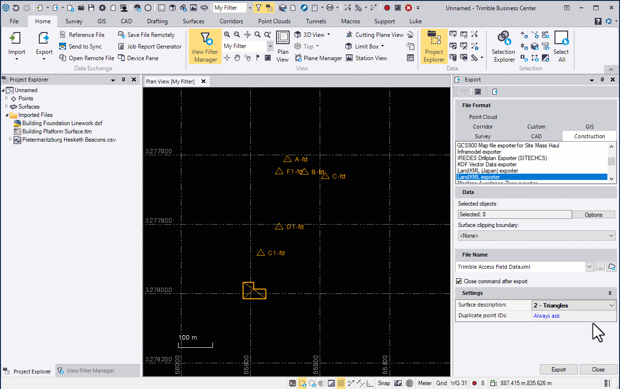

Hi @Tex Barnett, The current workflow, using Connected Workspace, currently does not offer the ability to upload from TBC to TA. That workflow is being introduced in v2024.0. You can still use the Save Files Remotely function when exporting any files for the time being or Trimble Sync Manager. I hope this helps and I'm glad to hear you're using the new Connected Workflow, I find it much easier to use when exporting from TA/Connect.
